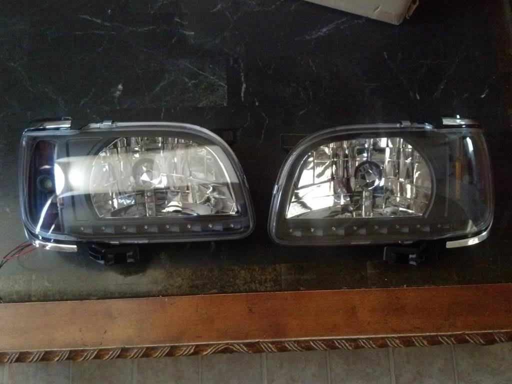

    These ones. That's all that is available as a one piece unit. The light output is not as great. And are prone to leaking. They would be 'ok' if you resealed them, and clear coated them before install. Or even doing a retrofit in them. But again, they won't last nearly as long as the oem type. They might be ok on a street queen. But off roading or rough roads will take its toll on them. My reflectors have broken loose off one of the pivot balls. And are yellowed and the trim is cracked and peeling. I'm doing another retrofit with new ones. Plan to clear coat them and take extra care. Seehow long this pair will last before I go back to the two piece units.

    Better just to break bread and get some quality retrofits. They don't have to be the most expensive ones.
