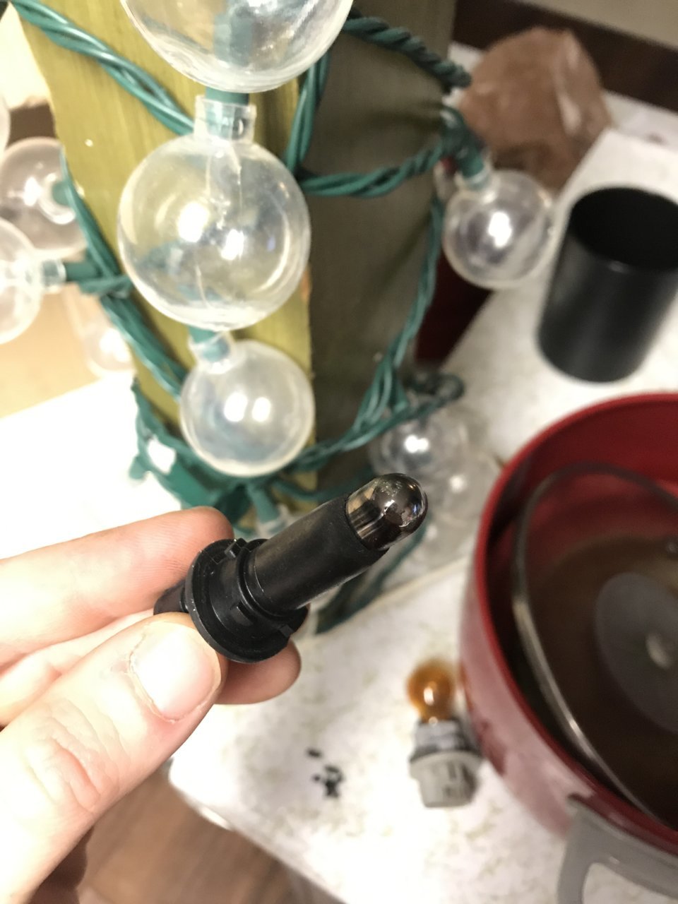

    I just bought a set of headlights to replace mine with broken tabs. I was taking them apart to sand down to get rid of the plastic haze.
    I was taking the bulbs out and noticed that they all have cracked o-rings. One of them just fall apart into several pieces. Now the bulb fits really loosely without the o-ring. I was thinking I could just shove a similar sized o-ring on there to compensate, but is there a better replacement?
    Also, what is this other bulb thingy? It was way up in the corner. It almost looks like a temp sensor, but I'm pretty sure it's a light. This is a set of "blacked out" headlights, so maybe that's why it looks the way it does.

    2nd pic is your parking light.
    the bulb pops in and out of that plastic shroud/extension. Its just a typical 194 wedge

    toyota part#
    for large base (blinker)
    9007560060

    Smaller base (parking light)....the goofy connector
    heres your other part# sir
    90075-60056

    Yessir.... srry if i left anything out. I couldnt find the grommets seperately. Maybe call ur dealership with the part #s i left and tell em u want just the grommets if possible?

    I think you could substitute an appropriate sized o-ring for that lamp fixture and it would work equally well.
