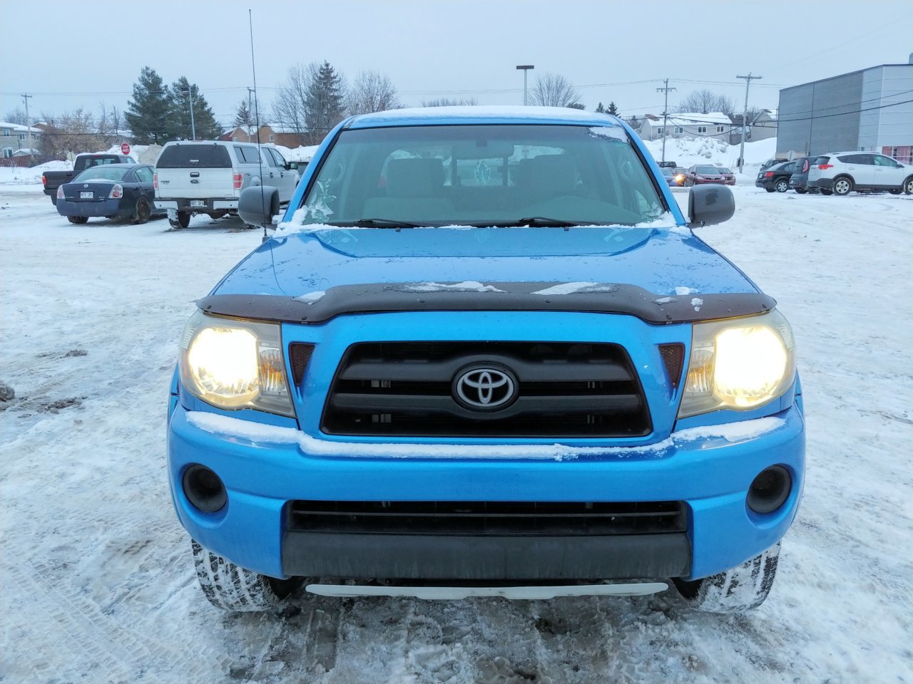

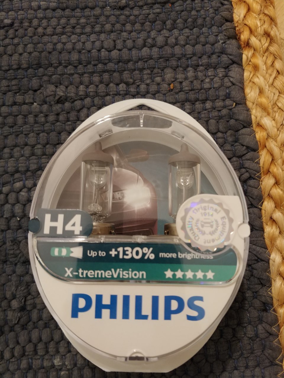

    I picked up a set of Philips X-tremeVision +130% and just installed them a few minutes ago. I have to say, the pictures don't do them justice. My lenses are dirty and covered in salt and in person they look extremely white and clear.
    I can't wait to drive at night and try them out.
    crashnburn80 and Sterling_vH111 like this.

    I have those as well, and am quite happy with their performance

    Those are good bulbs to balance performance with bulb life, as they are rated at a reasonable 420 hours. High beam performance is down though since they coated the high beam on that bulb.

    I had no idea it was coated. For some reason I was under the impression that it wasnt but either way I'm happy. I'm betting the low beam on these are still an improvement over the stock high beams :)

    Here is a photo. Many manufactures do this to give a whiter look without significantly reducing performance, which can work well on a single filament bulb, but on a dual filament like the H4 many end up covering the high beam filament.

    @crashnburn80 I completely forgot to check the bulbs (the ones in the package are the stock ones).
    Seems like I have the same ones.
