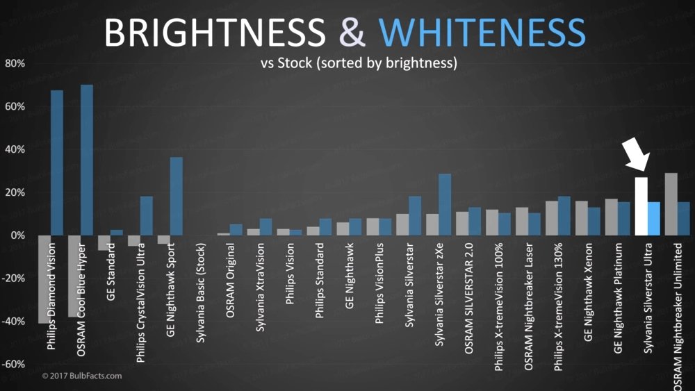

    That lawsuit was in 2011 and Sylvania agreed to change the packaging on the product. The SilverStar Ultras are much brighter and have much greater throw than the OEM halogen H11s that came with my 2020 TRD OR. I still have the old halogens and they are dim by comparison.
    From BulbFacts, the SilverStar Ultras do pretty well.

    Valid point on the date of the lawsuit. Note that sites testing is pretty flawed, though less-so for halogen. It is also worth noting that those results also do not appear to be from a projector, which favors different performance characteristics than a reflector. There is no doubt that the stock bulbs leave a lot of room for improvement but the human eye is easily tricked with whiter light appearing brighter even though that is not always the case.
