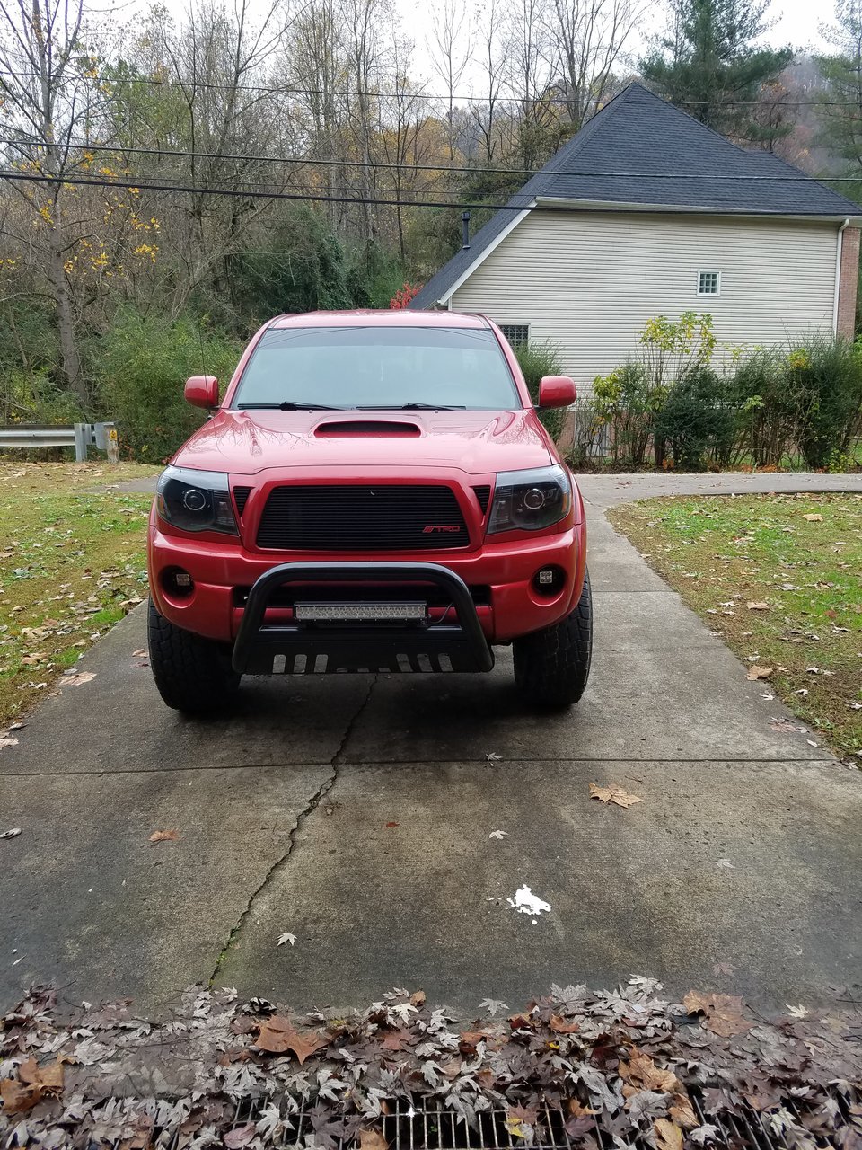

    Quick question y'all, I just resealed my headlight with some more sealant, I noticed 2 plugs with rubber caps over them, should I remove the rubber caps because theese are vents or should I leave it on?

    I taped some silicone packets behind the plug, and left it on, not sure the packets will do anything tbh, I have a handful of them left...should I do anything with them?

    That will most deff be my next option, I just don't want to have to buy another set because I bought a set before they were the jdm, black ones with the reflector, loved the look but they were full of water so I bought theese ones now for 200, light output is great and they look great, sealed them and now I'm in the same boat

    I re sealed them and dried them out today, they've been in for over an hour and I've drove down the road and everything and no moisture....i pray it stays lol
