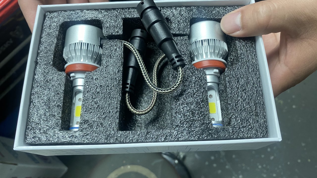

    Ok I had a headlight burn out. I've previously swapped brights. Previous owner dropped in LEDs.
    Ordered h11. Great learned today that is the base shape.

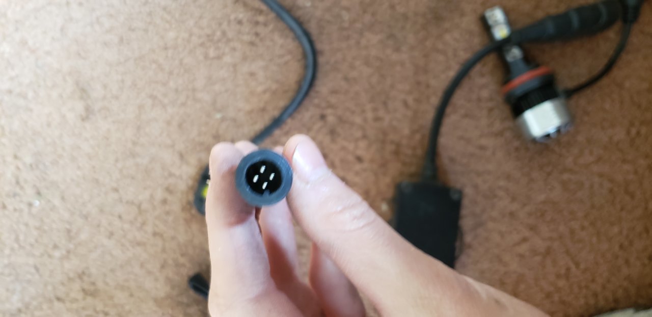

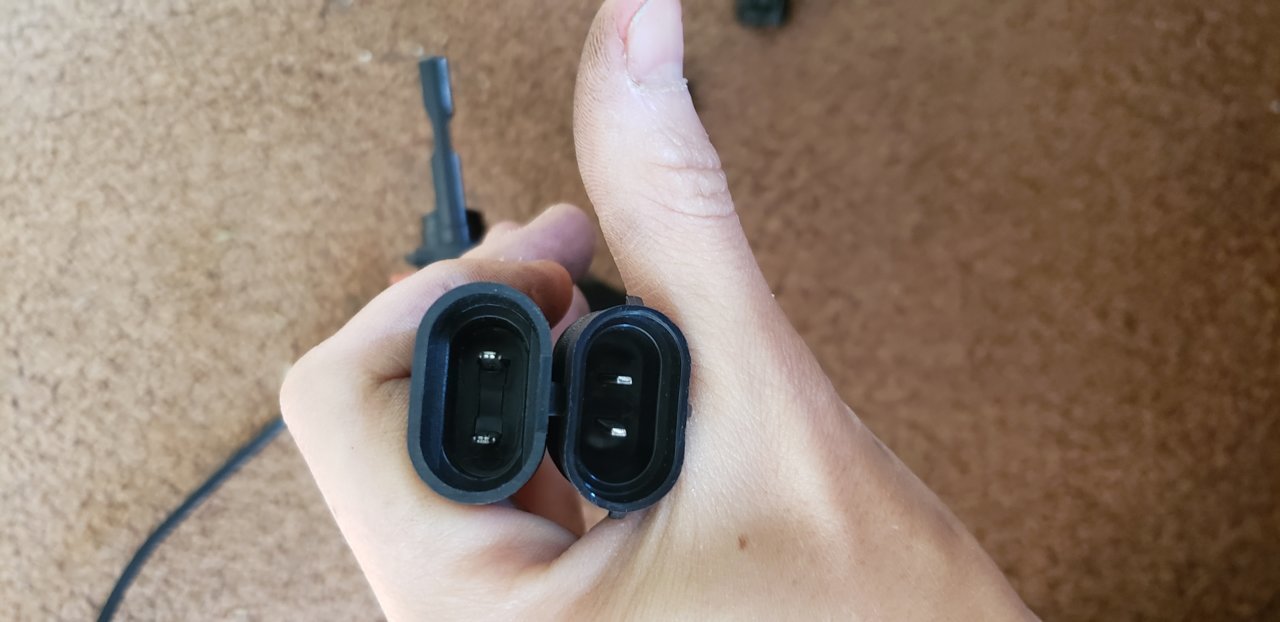

    Went to plug them in and they didn't fit. Then realized there was an adapter on it to make the 2 pins wider. What is that connector called? The wider pine arrangement.. I'm thinking maybe a 9006?

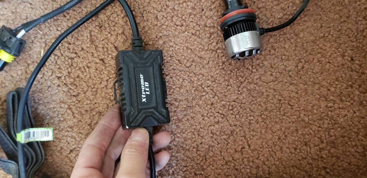

    Next the lights then have a box of some sort with the plug on one end and a 4 pin cylinder plug on the other end.. what is the box for? I figured maybe a fuse or a resistor?
    Then last one is what is the cylinder plug called?
    So why go through all this trouble with adapters.? I'm guessing maybe just the bulb is out so I'm keeping all the adapters to get more info and decide if I want to get the extreme LEDs.

    The box that says Xtream LED is the led "Driver" necessary to run the LED bulbs, kinda like an HID ballast. (must have been built-in on your old ones). The other plug does look like a 9006 bulb connector, IDK why you would have that though.

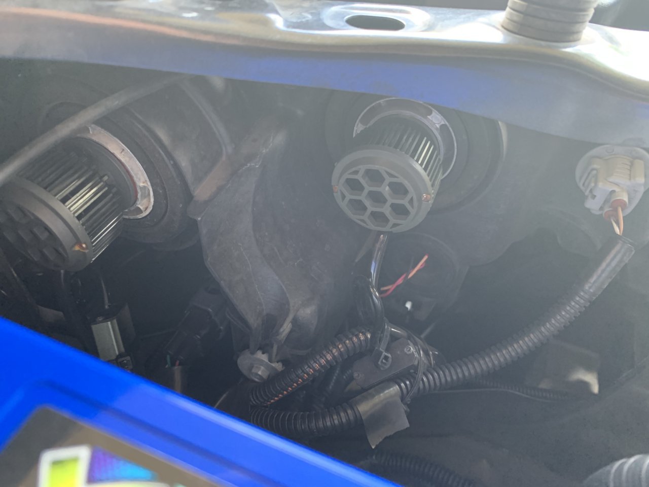

    Here is a picture of the back of my housing with the LED lamps installed.
    I remember now that I did have to loosen the headlight mounting bolts in order to get the LED bulbs in the socket for the low beams in the projectors.

    More detail on the driver? Because the LEDs without that box dropped right in. Funny they are aimed differently when I compared the new ones to the old one didn't mess with the aim at all but somehow it was changed.

    The LEDs themselves can't run on 12 or 14 volts, they run very low voltage (maybe 2-4v) and require a steady current flow, something no vehicles 12 systems can do. The "driver" steps down the voltage and regulates the current it so the LEDs can operate properly. On your original bulbs the driver must have been built-in vs. external. As for the fitment and aim that may be a difference in the brand. Also some LED bulbs can be adjusted (rotated) on the base to get the proper alignment.
