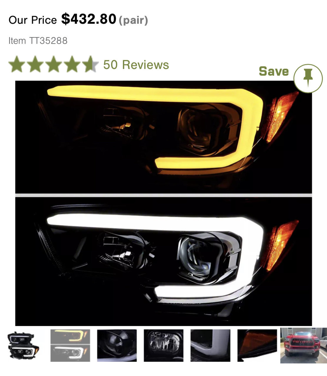

  15. Aug 1, 2023 at 7:14 AM
    #35
    hilighter
    hilighter [OP] Master of Disaster
    Apr 12, 2022
    #394900
    252
    Portland, OR
    21 Tacoma MGM TRD OR DCSB ABCDEFG
    3” Ironman IM2.5 lift Body Armor stubby front bumper 10k Superwinch Ironman Raid rear bumper Custom sliders Nomad 501 17x8.5 Satin black wheels Smartcap Dashmat
    I found some new ones on eBay, black housing from a Limited. I’ll just sell these I suppose - although I really like the “halo” on these.
    *Pic is of what I tried to make work.*
    Btw, if anyone is interested I’ll post these up in the proper thread once I install the replacements.
    #35
  16. Aug 1, 2023 at 7:20 AM
    #36
    daveeasa
    daveeasa FBC Harness Solutions
    May 14, 2020
    #328079
    7,460
    David
    PNW
    2016 Tacoma OR DCSB 6MT, 2005 RC 5MT PreRunner, 2002 Tundra SR5 RCLB 4x4
    Limiteds would have come with chrome like OffRoad and sport. Post the auction? Don't be fooled by knockoffs, there are a ton out there, they are not OEM quality.
