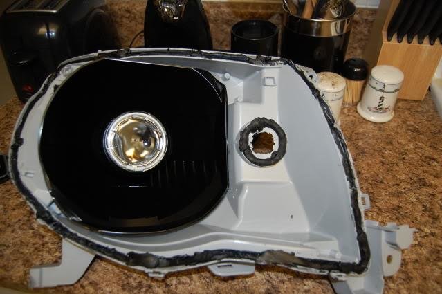

    Some here reuse the factory black adhesive when doing the BHLM. I agree with that you can't replace that black adhesive with silicone but silicone to seal around the exterior housing is fine. Try a hair dryer through the bulb opening to dry it out, then run a bead of clear flexible GE Silicone II you can get at Home depot around the connection of HL and housing. Also make sure the rubber boot of the bulb is secure when connecting it back in the housing. If this method doesn't work, remove the lens and old adhesive and use this:
