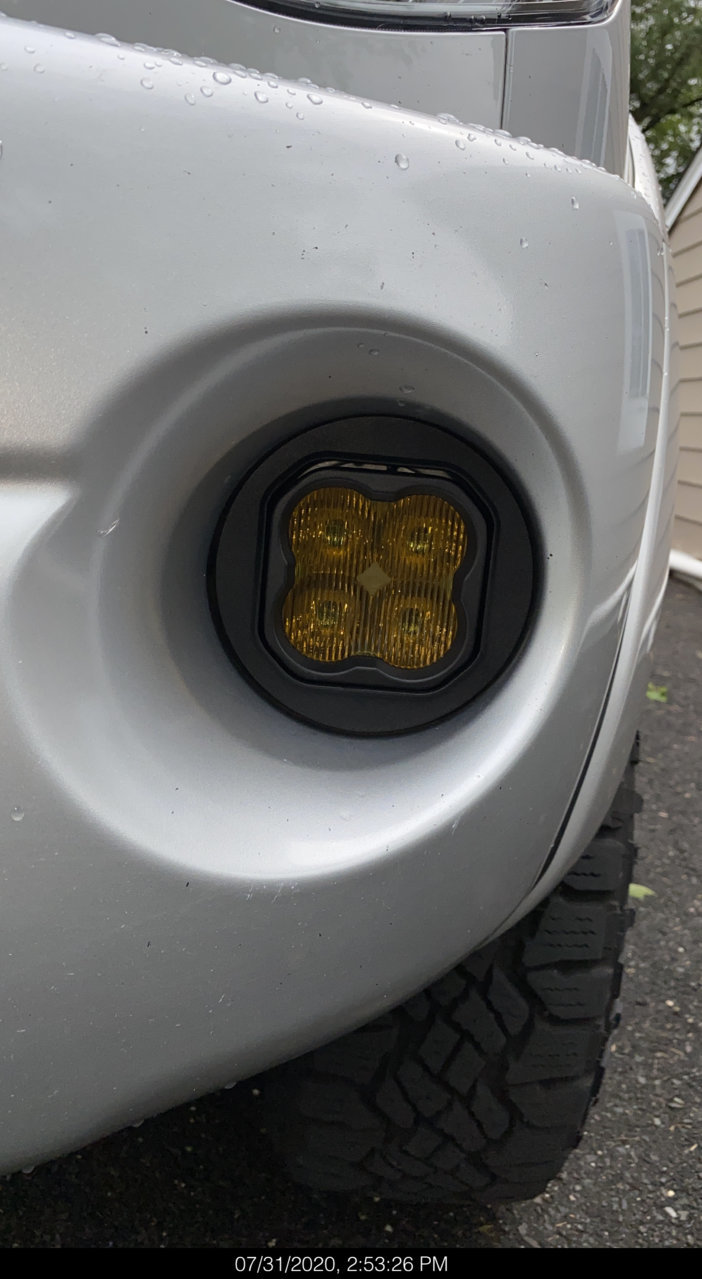

    baja squadron pros
    Go aftermarket. Diode dynamics make street legal dot approved lights and pretty reasonable you can get a kit for as low as $190 comes with everything you need i went with amber but they do sell white E92F5771-2038-4D2B-99B9-45782C33948E.jpg

    For headlights?

    My bad I thought fogs ... definitely go oem for headlights

    All good lol. I think the word “fogging” in the title might’ve done that
