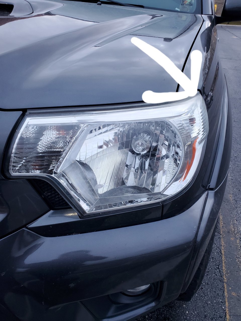

    Hey guys see this image. There is a small orange light bulb inside of the headlight housing that does not seem to be working on either side. Is this fuse related? Anyone know which fuse to swap out is it is?

    Burned out bulbs. It’s common.

    @Muddinfun is right. If it were the fuse, the tail lights wouldn’t work.

    Both of mine popped at the same time. I'm voting bulbs.
