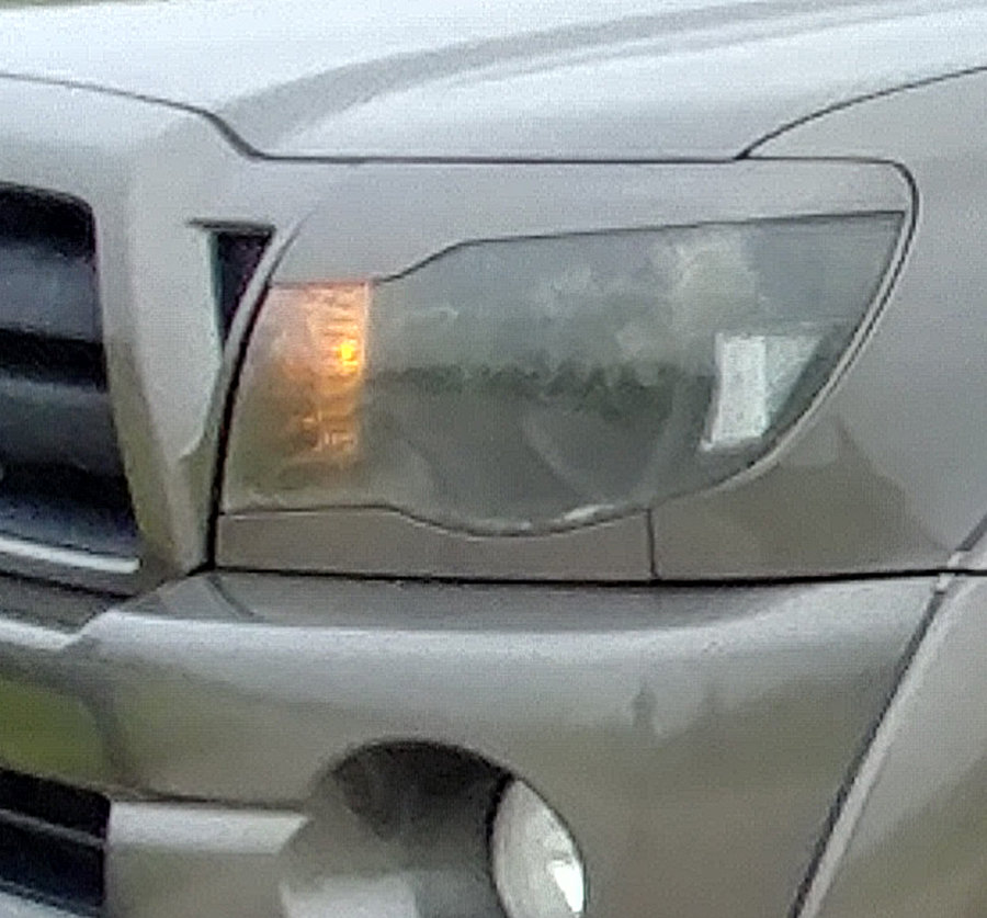

    Just finished up last night using 2000 grit sandpaper and a pad sander with lots of water.
    Before
    After
    lil_buddy likes this.

    there was a tsb out on these headlights (that burn spot in your turn signal, if thats what that is, was the reason). I have a 2010 and the dealer replaced them both free like 1-2 years ago. Might be worth checking. free new ones are way less work.
