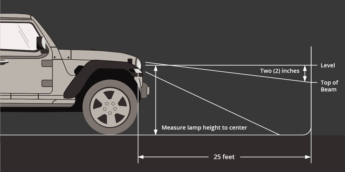

    Welcome to the forum. Here’s a picture of how to properly aim your headlights.
    478DblSport and lmccall717[OP] like this.
