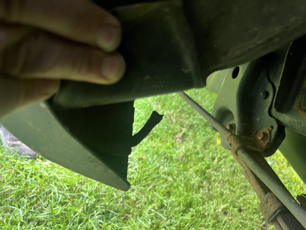

    It was the bulbs, ive had headlight problems last time i had it inspected i just had them fix it, and didnt know what they done. All in all it was the dim burnt out on both. I do have a problem finding a part now. It appears to be a brace behind the front inner portion of the wheel wells. It would give the front bottom part of the bed support. I just need to know the name of the part.
