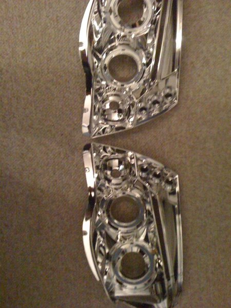

    I would assume you would have to sand before you paint correct? mine are currently painted chrome and I want them black so what would be the best way to get a nice paint job?

    Sanding is optional, when I finish mounting my fxrs on the reflector I'm painting them at the same time as the housing, I'm just going to clean them up with alcohol and paint. Plenty of guys on that have not sanded and no one that I know has any issues from not sanding.

    a lot of guys here, myself included have used Krylon Fusion, no sanding, no primer, no problems

    Its already separated from my projectors. I am just switching it from chrome to black with some white accents.

    This is what I am gonna paint tomorrow, I haven't done it yet.

    no clear coat needed, but i did my painting on OEM lights, i have no idea what to say about aftermarket halos
    maybe use plastidip then just peel it off the areas you dont want covered?
    yes, for sure

    Krylon fusion, clean really well, wipe with alcohol, then make sure its all dust fee. a few coats of the fusion should work ok. and when you put it all back together seal the sh1t out of everything, theres a lot there to leak
