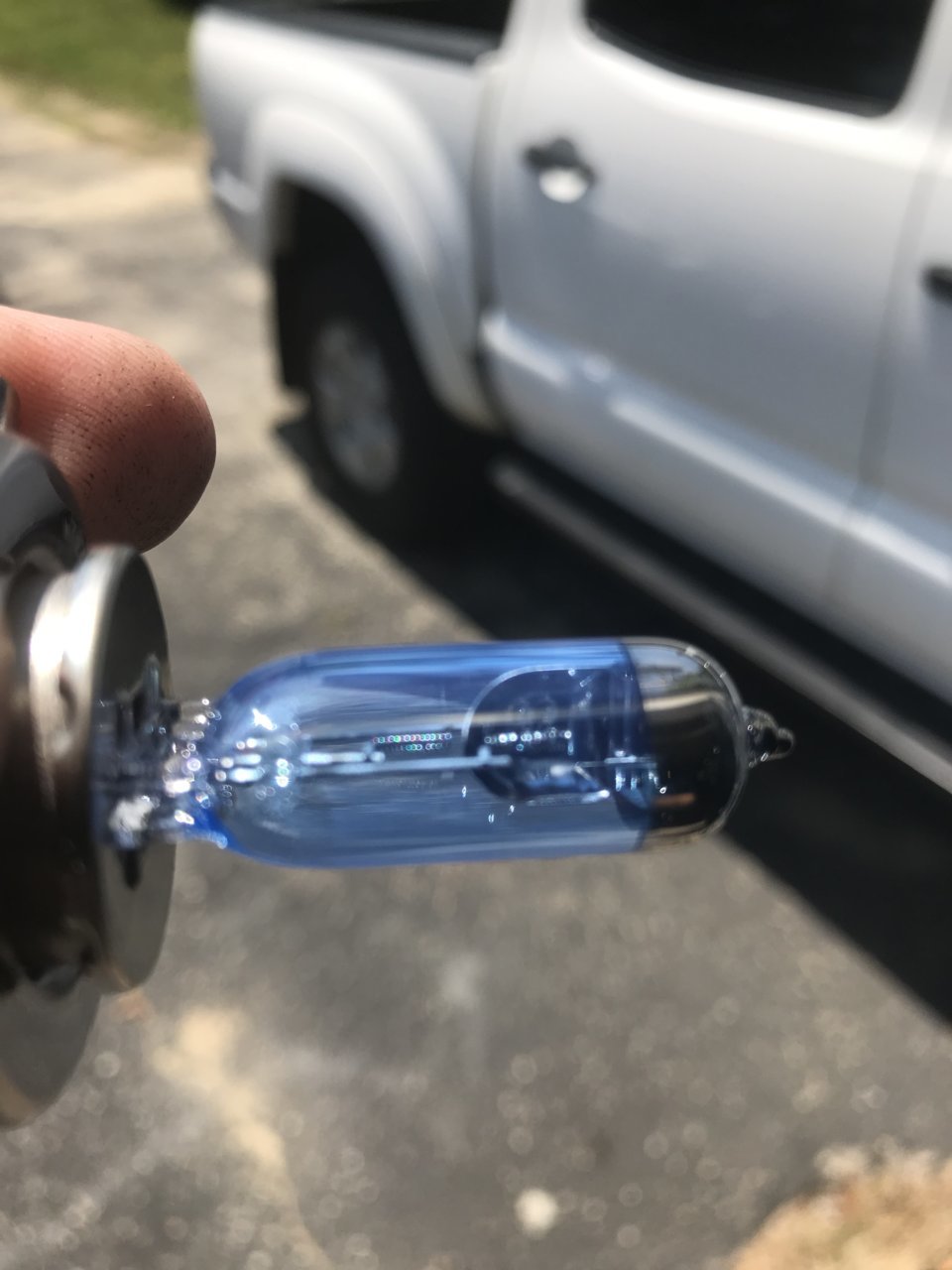

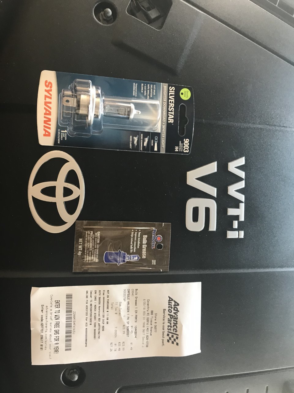

    In the first year my headlights went out. I change them with OEM and in less than a year they went out again. I “upgraded” to Silverstar ( Picture to follow ). In less than six months my driver side is out in less than six months my driver side is out again.
    I am very confident that I did not touch the bulb. I did not touch my face with my glove and then touch the bulb. Of course, but stupid spring clip is a PITA. The wiring is intact with no issues, the connector is good.
    A Google search shows that this is a common problem with Toyotas.
    The old burned out bulb has no hazing ( Picture to follow ).

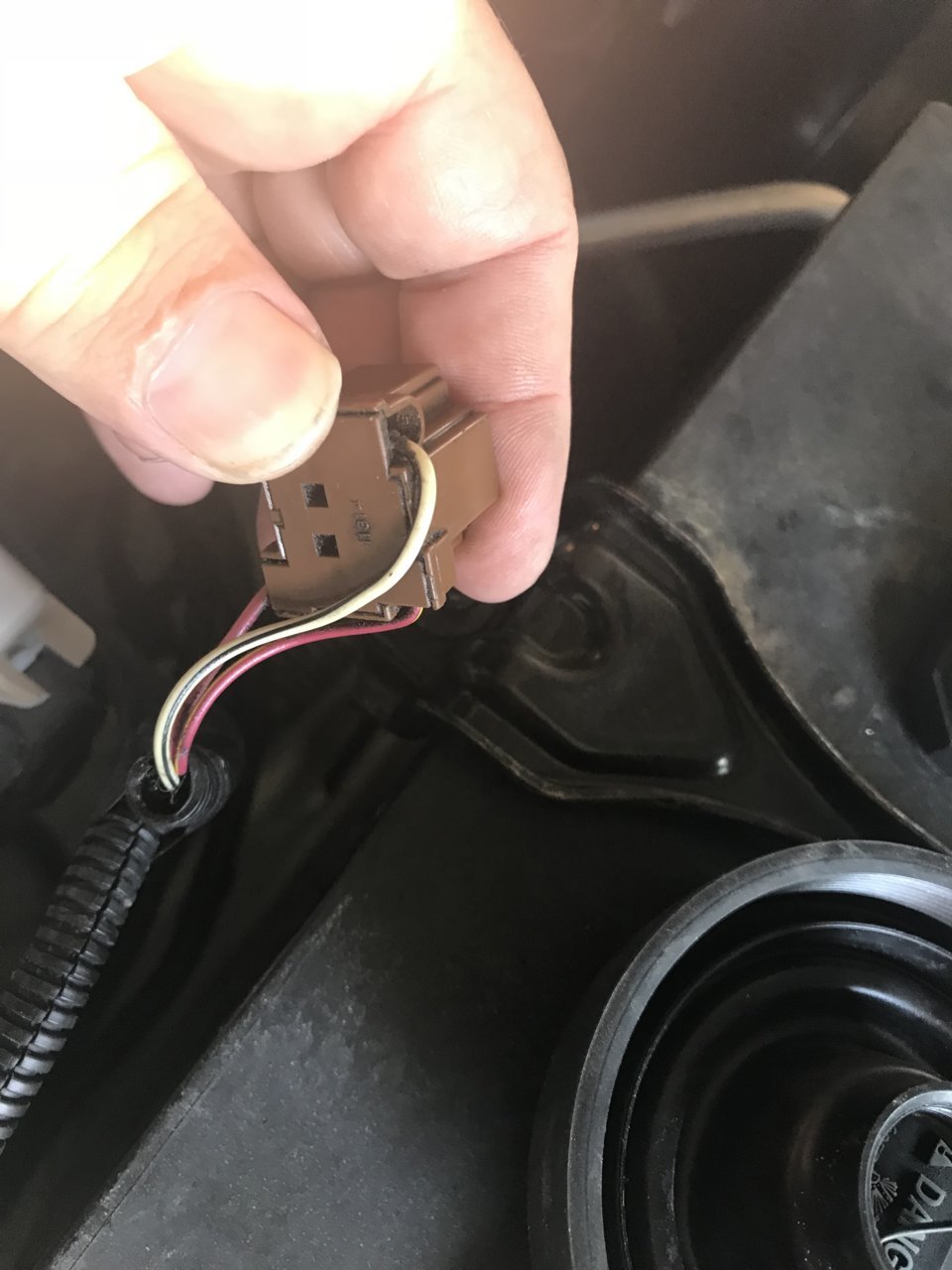

    I have read the posts on this forum for months. Differences in bulbs could account for subtle changes and longevity, but not to this degree. I noticed the back of the connectors have two slits build into them. Are these supposed to remain open for ventilation, or should be packed with bulb Greece?
    I am suspecting that moisture could be getting in through those slips and shorting out the bulb. There is no humidity in the headlight area. But those slips only access the wiring connectors.
    First picture is the old bulb.
    Second picture are the openings in the back of the connector.
    Last picture is the bulb that I am using.
