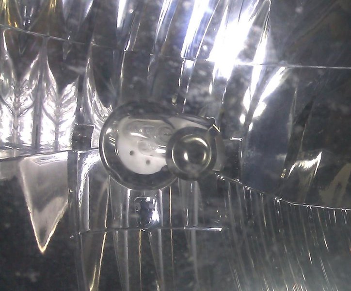

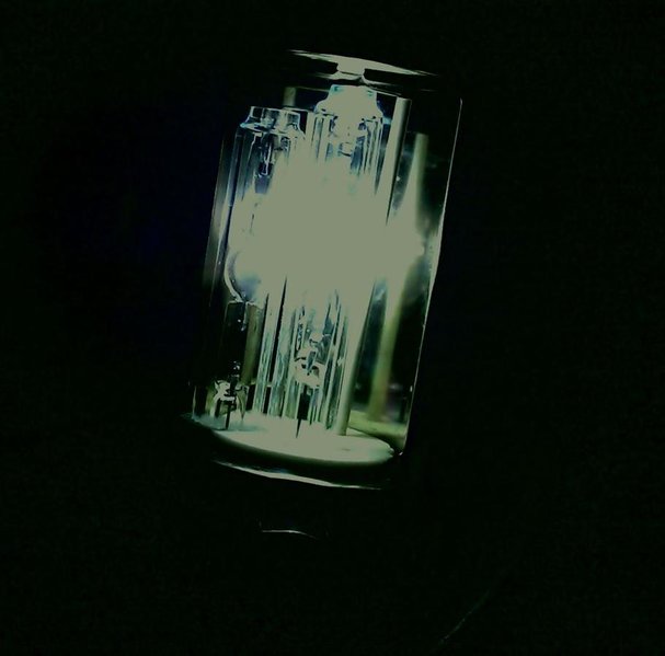

    OK, I JUST ERASED THE POST I WAS GOING TO LEAVE OUT OF RESPECT FOR THE FORUM!
    first off, before being so arrogant do some reading. no where did i state i had cheap bixenon/halogen bulbs are cheap dual HID wanna be bulbs that just move a little lever!
    i use dual 55watt HID XENON HI/LO bulbs as stated, if you need a picture reference i attached one, in my hand from my truck that i just went and pulled out the assembly!
    i looked at the ballast for brand and the brackets cover almost all of the housing and i am not about to take more stuff apart to prove a point to an idiot, but the part numbers are on the edge they are MDE-0304, i have 4 of them, 2 for each headlight assembly, and then 2 more for the fog lights, when i take the front apart for the 2005 to 2012 mod i'll get you all the info you want
    AND YES IT MAKES A huge DIFERENCE IF YOU HAVE BOTH xenon bulbs firing at the same time verses just 1. in a shared parabolic environment, the light immediate from 2 separate sources that are located at slight offset from each other will produce vastly different spread.

    Well Thats the first I've seen of a dual capsuled rebased hid bulb.... Nice.
    So its 2 running at 55 watts each in 1 housing?
    I've only used philips d2s in projectors.... Never tried a dual capsule or single in a halogen reflector bowl.

    man you are so right! it amazes me, first that people think they have 8000K lights because if they were they could barely see them! second the higher you go from about 4500k the less light is produced that humans can see.
    i have been adding HID's to my vehicles in every possible form for over a decade, i have literally tried EVERY combinition and brand there is.
    THE BIGGEST PROBLEM IS FINDING A SUPPLYER THAT WILL PRESENT TRUE SPECS!
    if a supplier says he has 8000k, 10,000k, 12,000k just hang up the phone because its a scam, otherwise you are buying boarderline ultraviolet light as headlights? pretty useless huh?
    if you want REAL white light like you see in the expensive german cars get bulbs that ACTUALLY produce light at 4500k to 5600k
    that is the WHITE light with no yellow and tiny tiny tiny hint of purple that you really looking for.
    AND that range produces the most visible light that will actually be seen and will light up the road
    hope that helps some folks, sorry i get so frustrated with all these scammers selling garbage to good people
    i just now pulled mine out, this is a TRUE WHITE LIGHT 5400K bulb ignited, its pure white, no yellow, no blatant blue etc
