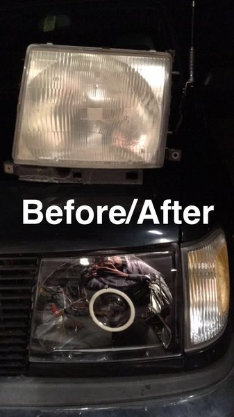

    You’re probably seeing retrofit headlights, which are HID’s and sometimes LED Halos in an aftermarket housing.
    They can range from $500-$1,000 if you have them built.
    Here are mine, I bought everything from The Retrofit Source. I had a member on here build them for me. (You need to put the headlights in the oven to melt the adhesive) Specs are:
    • ACME H1 HID's
    • 6,000k Bulbs
    • 90mm Morimoto XB RGB Rear-Mounted Halos
    • 80mm Morimoto XSB Switchback Front-Mounted Halos
    • Gatling Gun 2.0 Shrouds
    8CBA4DC9-CFDD-4ADE-96A9-1DD18801C1C5.jpg 4A5BFC47-A0C0-482E-BCFF-FC22D96B446E.jpg
    There exists ready to go “retrofits” for about $100-200. Do not buy them, they may look good, but they are not true HID’s. They are terrible quality and have worse light output than stock.
