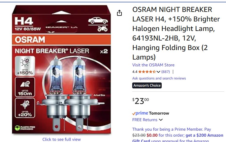

    HERE YA GO, JUST PUT THESE IN, THEYRE AWESOME AND MODEST
