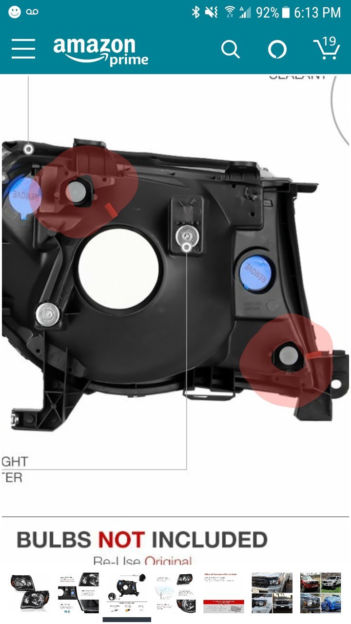

    But leaving the rubber plugs on Will keep air out somewhat, should I remove the caps to expose the vent to allow air in? the red circles are what I'm talking about
  4. Mar 20, 2018 at 3:54 PM
    Boyk1182
    Boyk1182 Well-Known Member
    Oct 15, 2017
    #233074
    4,765
    Northern Colorado
    I think those caps are designed to allow the headlight to breathe, I would leave them alone. Isn’t that what they do in the state they’re in?

    I would think that's what they do. ill leave them on, I'm hoping this window weld then silicone will be enough to keep water and moisture out:thumbsup: plus silica packs and the vents on the rear
  6. Mar 20, 2018 at 4:12 PM
    Sandman614
    Oct 26, 2010
    #45273
    35,914
    Tim
    Garner, NC/Boone, NC
    '06 SR5 Off Road
    The rubber caps have Foam inside them to allow it to breathe but not allow as much dust in.
    Justyn98[QUOTED][OP] likes this.
