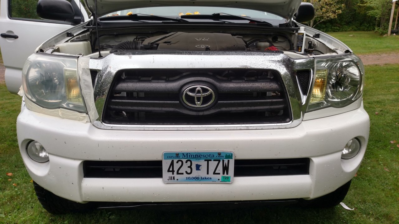

    Save yourself a little cash and buy a headlight restore kit. I had excellent results.IMG_20190907_105944589_HDR.jpg

    And unfortunately pretty much junk.
