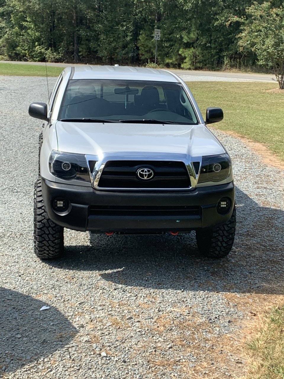

    70$ eBay housings. 30$ eBay projectors

    what brand of housing is that?

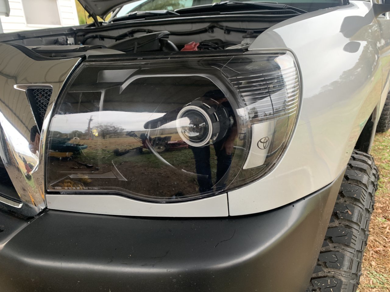

    Cheapest oem style light on eBay like 68$ a set. Then I retrofitted eBay projectors into them. Along with painting everything inside. Cut off on the projectors is pretty good considering this was my first retro.

    How long have you had them for? That is a good look for sure....

    I built them a few months back. I took my time on them and spent a few weeks painting and mounting everything inside. They leaked moisture once so I opened them back up and sealed them again.

    This is about the best way to do this if you want a custom setup. I've got RX350 projectors in mine and it's quite a big improvement, especially the high beams! Otherwise if you don't plan on a retrofit OEM headlights are the best to get.

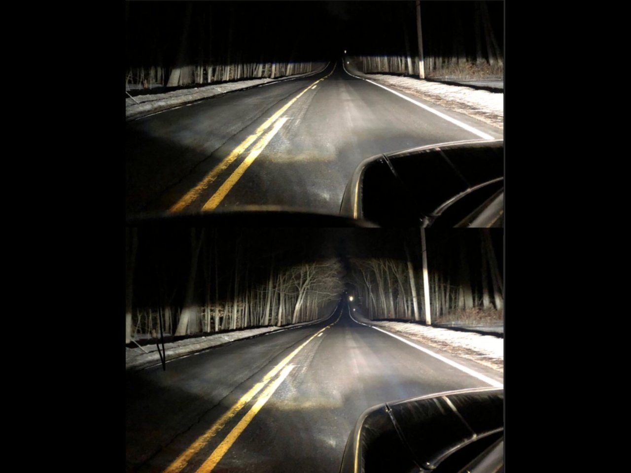

    V6 5sp,RegCab,TVS1320 Supercharger, 56mm pulley, methanol injected Haltech ECU, AC Tvs1320 supercharger,(MUST DO) every 125,000- 150,000 needs rebuild Projector headlights HID 5 speed manual Amsoil for all drive train Smaller 56mm custom pulley, (MUST DO) 2004 DESNO fuel injectors, zero ping ping, 2004 side door mirrors Dick Cepek Rims, Michelin tires LTX, ATM Pathfinders Dynopro ATM ( that last 100,000 miles) Now running Dynopro ATM mud and snow tires KN cold air intake Cat back dual exhaust with ss exhaust tip, Raised exhaust tail pipe to 2" below body line Optima*dry cell battery,red top Alpine sirius radio, 200 watt amp, focal is165 split door pod speakers Focal door speakers Subwoffer behind seat Viper alarm, Electric Locks Dark tinted windows, bucket seats corbeau lg1 Tacoma Rubber floor mats TRD fender extenders, Bilstien shocks, King shocks JBA UCA trailer iv hitch, electric brake control, Drilled slotted brakes, High carbon steel (MUST DO) EBS green stuff 7000 series pads(MUST DO) TRD engine oil cap TRD stick shift, Marlin crawl shift kit. Rear sliding window 2002 4Runner functional hood scoop cut into Tacoma hood, 4Runner dual overhead map light Gentex Auto dim + Compass + Temp, garage,rearview mirror Snow Methonal kit stage 2 Custom 3 core aluminum radiator Linex bed liner Haltech stand alone ECU, Intake supercharger gauge. Stainless steel brake lines, Custom leather wrapped steering wheel, Haltech stand-alone ECU,
    Just go projector types, D2S or MINI h1 7.0 and be done with it.
    Here is high beam and low beam.
    One of my best upgrades

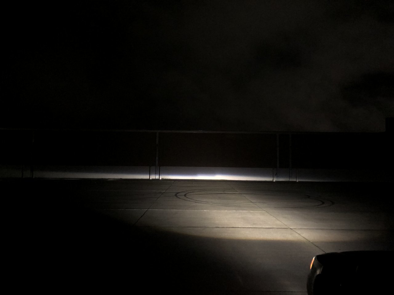

    I agree with the retrofit guys.....I’m a little partial though as all 4 of my vehicles have a retrofit. If you can splurge for a D2S projector I would go that route. Better output, higher quality bulb options, generally more reliable (though I haven’t had any issues with my H1 setup) and less bulb alignment issues. But they are more expensive. Buy once, cry once.
    This is my beater 01 Subaru with an ACME H1 projector kit from the retrofit source. $130ish for projectors, shrouds, bulbs, harness and ballasts. I have used the Amazon projector which is decent too, but then you need to order the rest of the components separately.
    This wall is about 80-100ft away.
    LOW BEAM
    HIGH BEAM
    I just got done with my Tacoma but haven’t gotten any output shots of it yet. But it’s amazing! RX350 projectors, clear lens swap, Osram NB Laser bulbs, turbine shrouds, profile halos and hella gen 3 ballasts.
