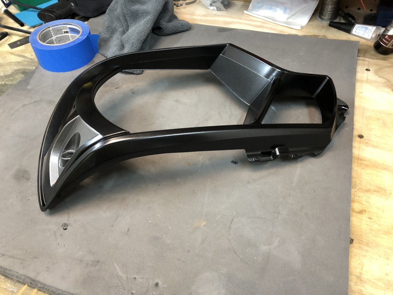

    They aren’t bad at all. If you still have the NON PRO headlights then you can paint the outer shroud black or whatever color you’d like. Just opening the head light you can’t really break anything, but I understand opening a set of expensive headlights is scary!
    I made mine kinda pro like. The paint I used was a metallic black but it doesn’t really show the metallic as well as I was hoping. I haven’t reconditioned the lens yet so it’s not as clear as it will be. I’ll be doing that this spring.

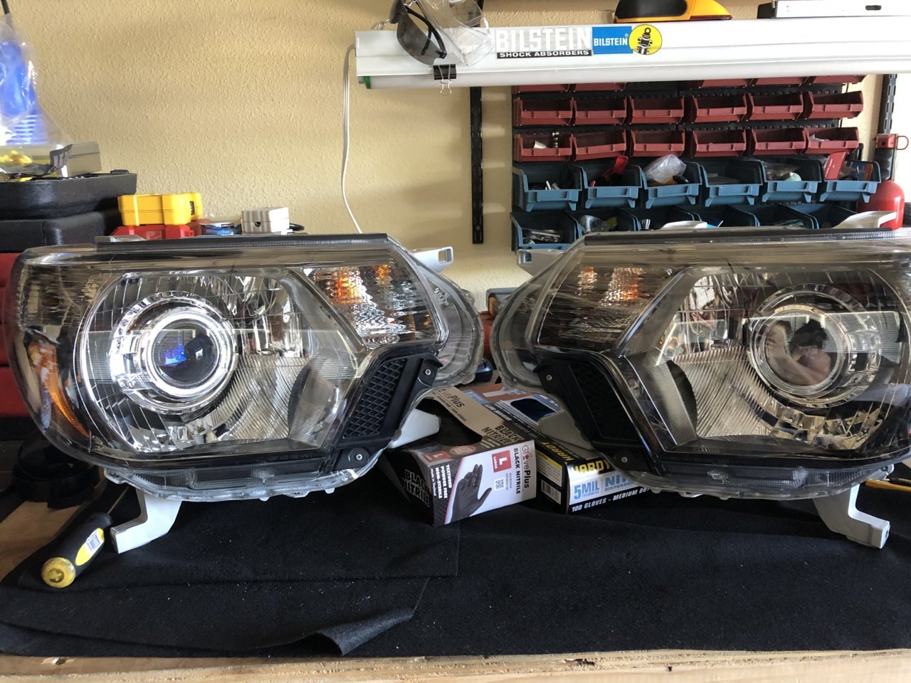

    I know the feeling. I cracked these open brand new right out of the box. :cool:

    Those lights look awesome! What projectors did you use, and how difficult is to do the mod?
