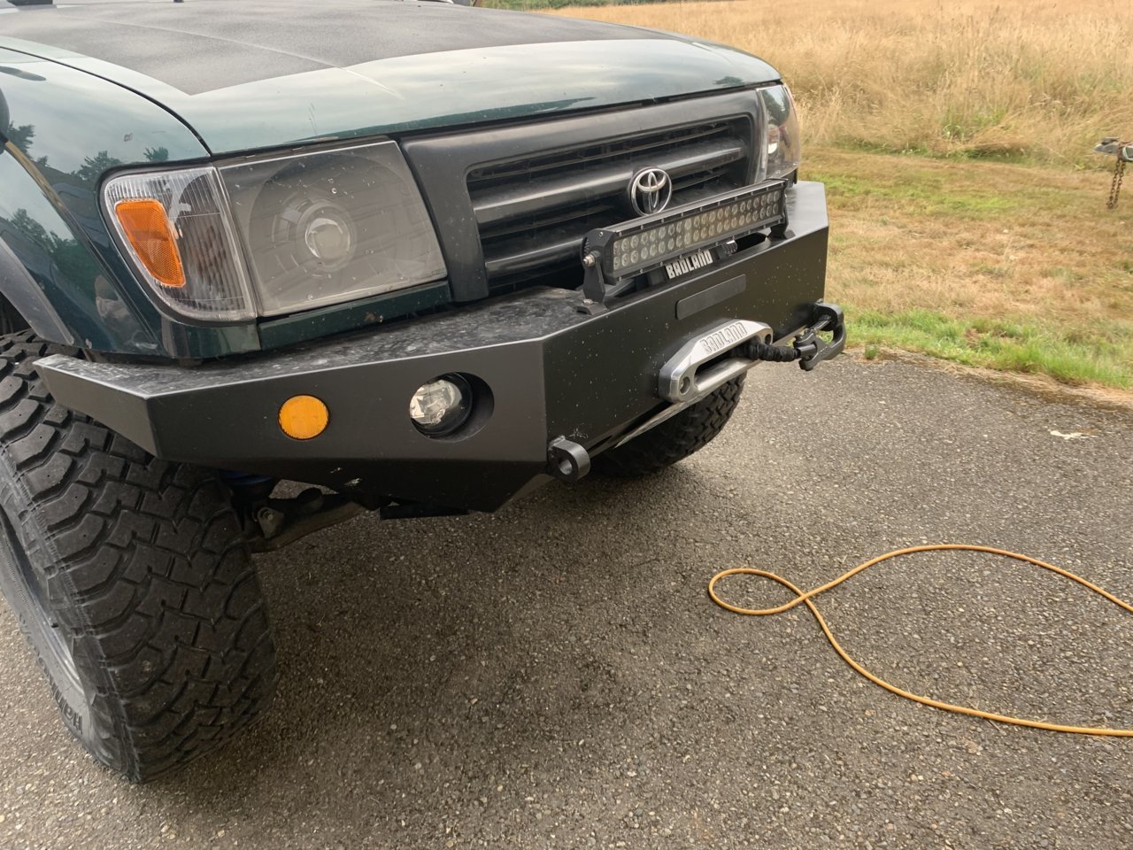

    so these are the ones I got of fleabay
    But beware
    (Were shipped from the states)
    Good: perfect fitment/wanted white HL(not a black reflector…look stock)
    Bad: despite add stating, no high beams
    And I had to adjust HL to lowest possible level bc would blind on coming drivers
    Think they were $85

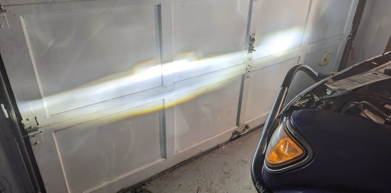

    I've experimented with a few setups. First I ran h4 housings with Hella bulbs and a few others. I recently installed AUXBEAM full replacement LED headlights which are supposed to be DOT approved I am pretty happy with the light output. There are some pics below, you can see that the Auxbeams put out a lot of light and have a pretty wide spread pattern. Night driving is MUCH better
