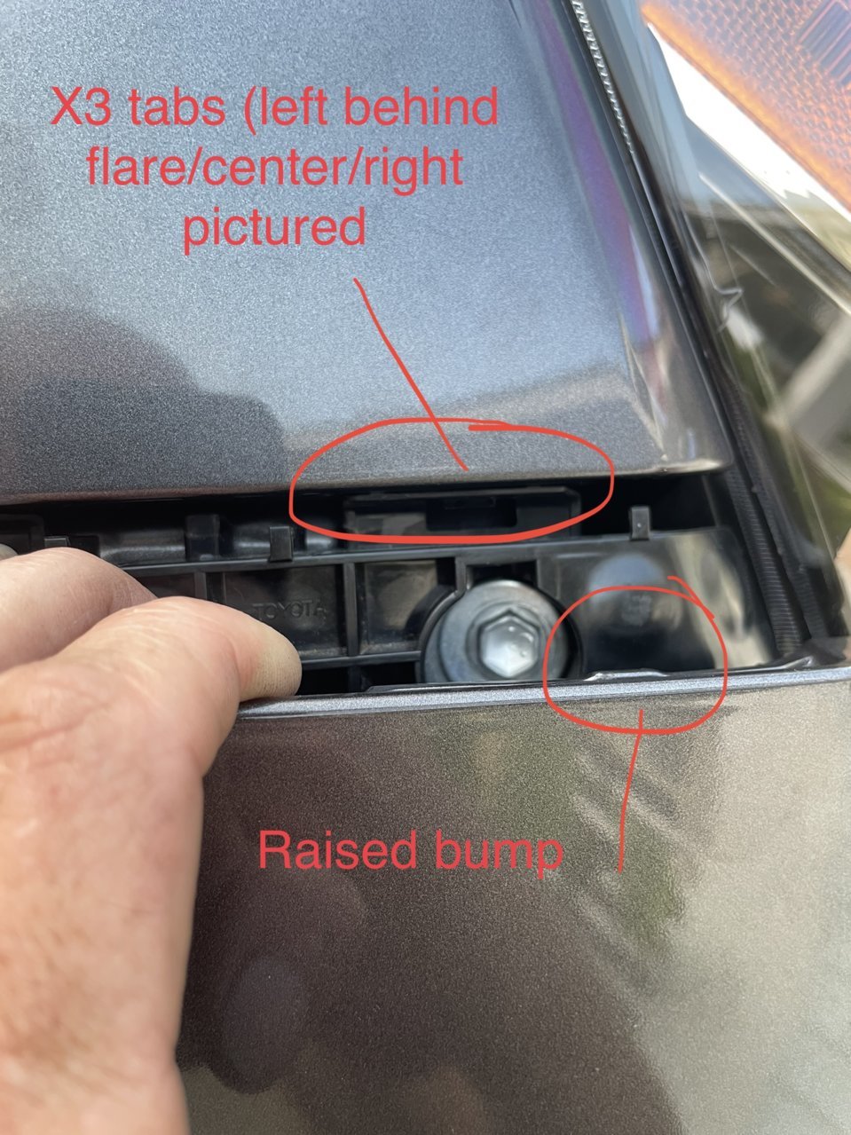

    Imo you don’t need to pull the flare that far from the fender that high up to cause the 3m to pull off. Basically just lift it off the fender enough to get access but not past the 3m tape
    the guide bracket is the biggest trouble. If you remove every tab/clip in order you won’t break it or a piece of it. I believe you push the red pin from the back first then the 3 tabs from the front
