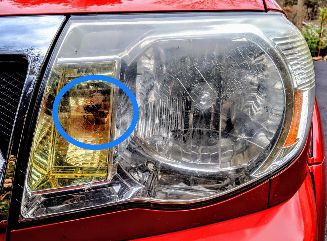

    This is common. It's from the DRLs never turning off since there is no option to kill them. The solution is to repair the burnt items including the turn signal bulb adapter housings and then replace the turn signals with LED units, as they run MUCH cooler and have much less amperage draw compared to their filament counterparts.

    I am not sure what I am looking at? The color is too dark? No idea. The turn signal still works.

    That orangy blackish bubbly look is melted plastic.

    Thanks! Reading the TSB, it is too late for my Tacoma. Also " Additionally this Service Bulletin does NOT address conditions with the outer headlamp lens. "

    Yes the TSB free replacement is expired. I just documented the Toyota TSB announcement for informational purposes. The outer lens statement is merely saying if the headlight lens has issues like hazing or cracking from UV sun exposure, it is not covered under the TSB. The TSB only applies to the inner DRL lens. When replacing your lights with the newer fixed TSB version which I provided the part numbers for, the entire thing is a non-issue.
