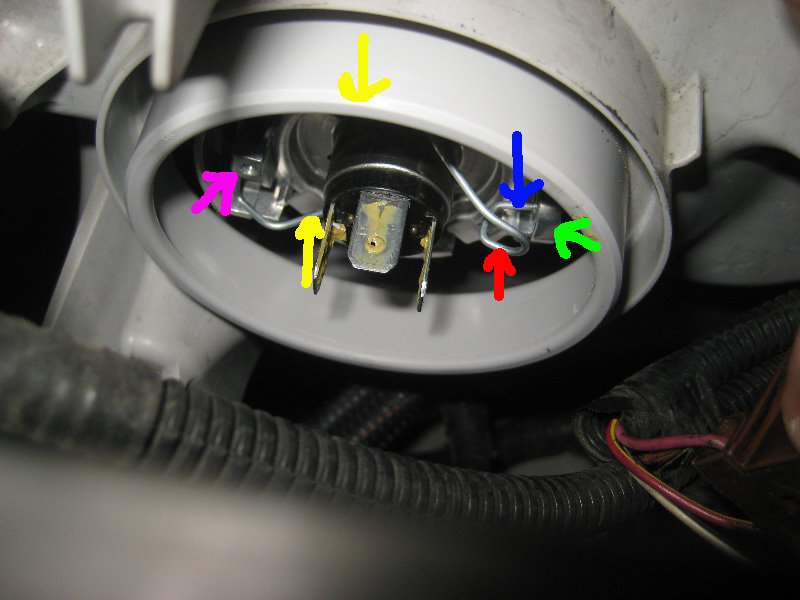

    In case you don't know how, here is how you get the headlight bulbs out of the housing.
    When you push on the bail at the red arrow with your finger, the bail pivots at the purple arrow. The bail contacts the bulb at the yellow arrows. The tail at the blue arrow hooks under the molded hook at the green arrow. When you push at the red arrow, you need to then move up or down to release or attach to the molded hook.

    Warning! Purple arrow is unpredictable and could be an asshole if it so desires by releasing the clip and having it fall out of the headlight assembly. Purple arrow will then become your worst enemy.
