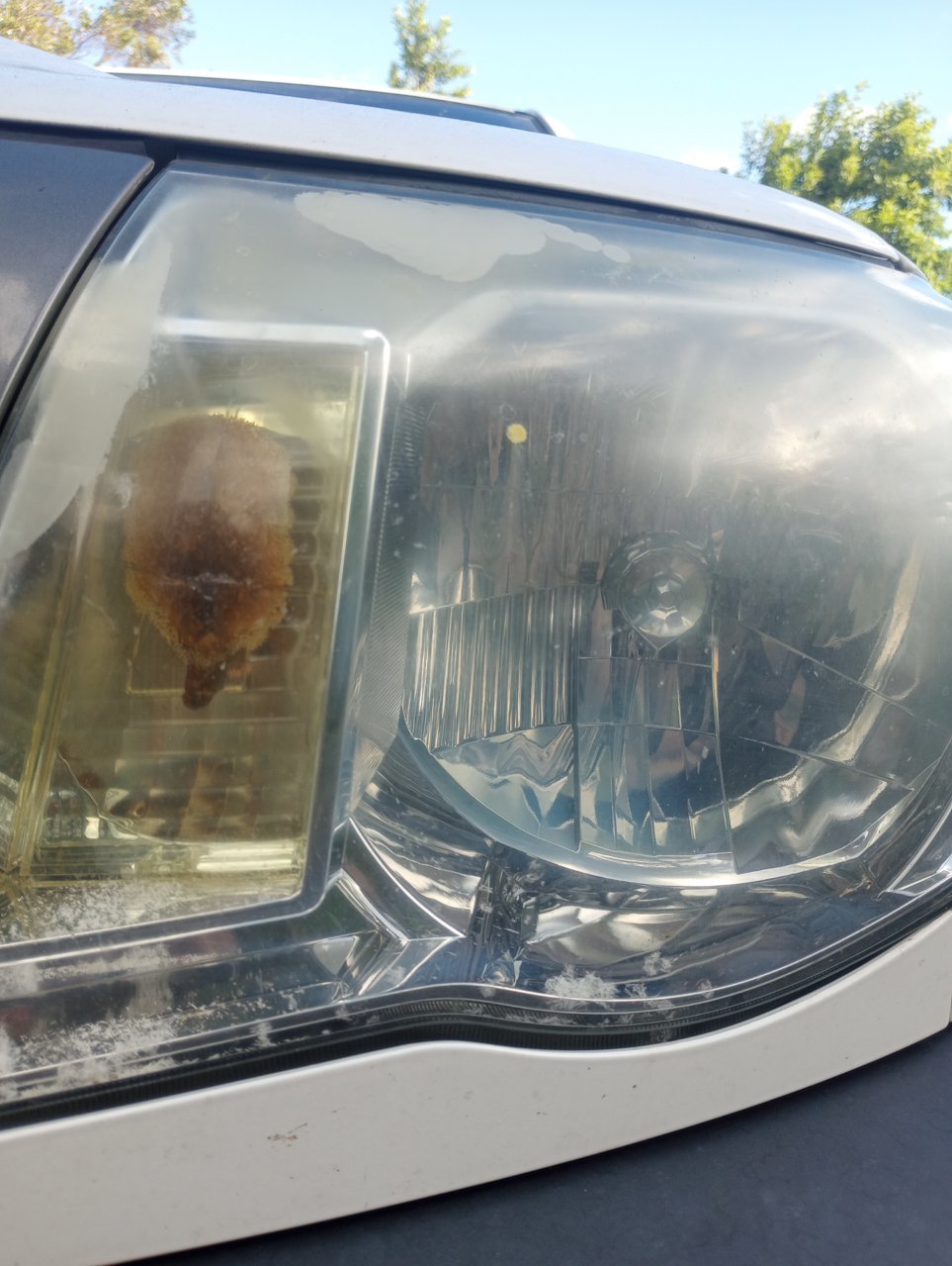

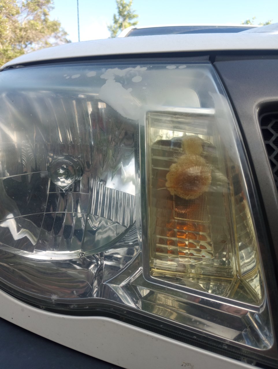

    I know it's probably an unaswerable question but why would Toyota discontinue the upgraded lights and continue selling flawed parts? I had a front end accident around 3 years ago and my insurance would only cover my damaged right side headlight so I paid out of pocket for a new left side so that the lights would match. A coworker had told me that Toyota corrected the problems of the DRL burning the lens so I just assumed all was good with the new lights since they were OEM Toyota, three years later I think the lights look just as bad or worse than the original lights on my truck.IMG_20230809_174240484.jpg IMG_20230809_174249673.jpg

    I don't think they are discontinued, I think they are just out of stock. I can still buy brand new made in the USA OEM lights for my 2003 Tacoma. Toyota does an outstanding job of supporting older vehicles with parts. I suspect they ran out of the newer stock and rather than ordering a new parts run decided to deplete their older stock first. I anticipate that at some point in the future the newer lights will be available again.
    An available work around, that is less than ideal, is to run LEDs in the DRLs or disable the DRL so it isn't on all the time at full power in the daytime.

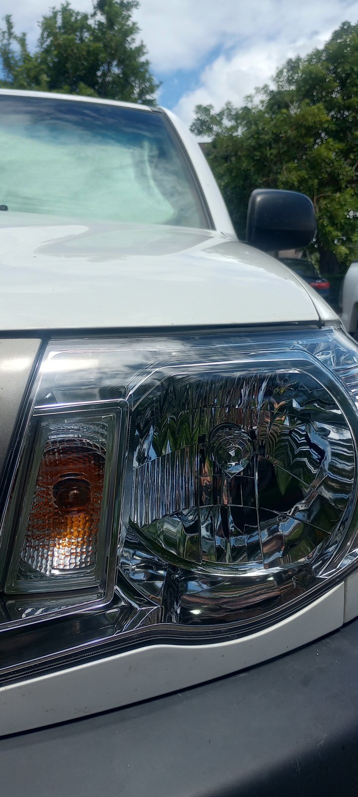

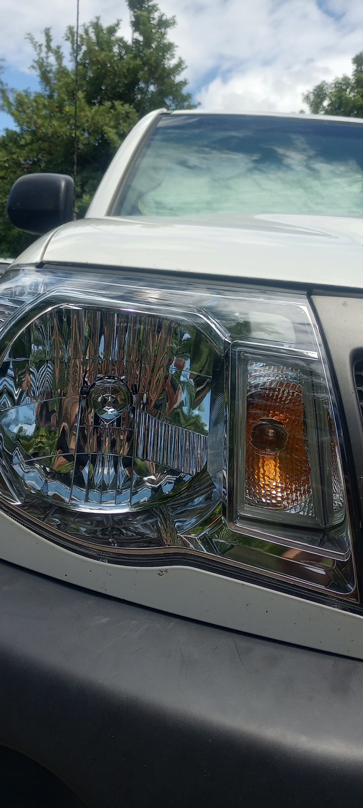

    Update: I ordered the part numbers from the TSB in post #5 above, 81110-04200 and 81150-04200. Took about 2 hours to replace, watched a couple YouTube videos which helped. IMG_20240629_133831737_HDR.jpg IMG_20240629_133838273_HDR.jpg

    Nice! Did you buy them from a dealership?
  15. Jun 29, 2024 at 5:57 PM
    KENNE-BILL
    KENNE-BILL [OP] Member
    Jul 30, 2019
    #300771
    9
    I ordered them through a dealership in Arizona, paid a little over $600 including shipping and tax. Local dealer here in Hawaii had them in stock at around $900, initially tried to purchase them off eBay from a Florida dealership at $540 but they do local pickup only - sent a few messages about shipping but no replies.
