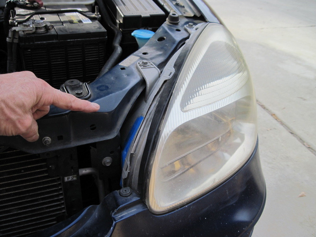

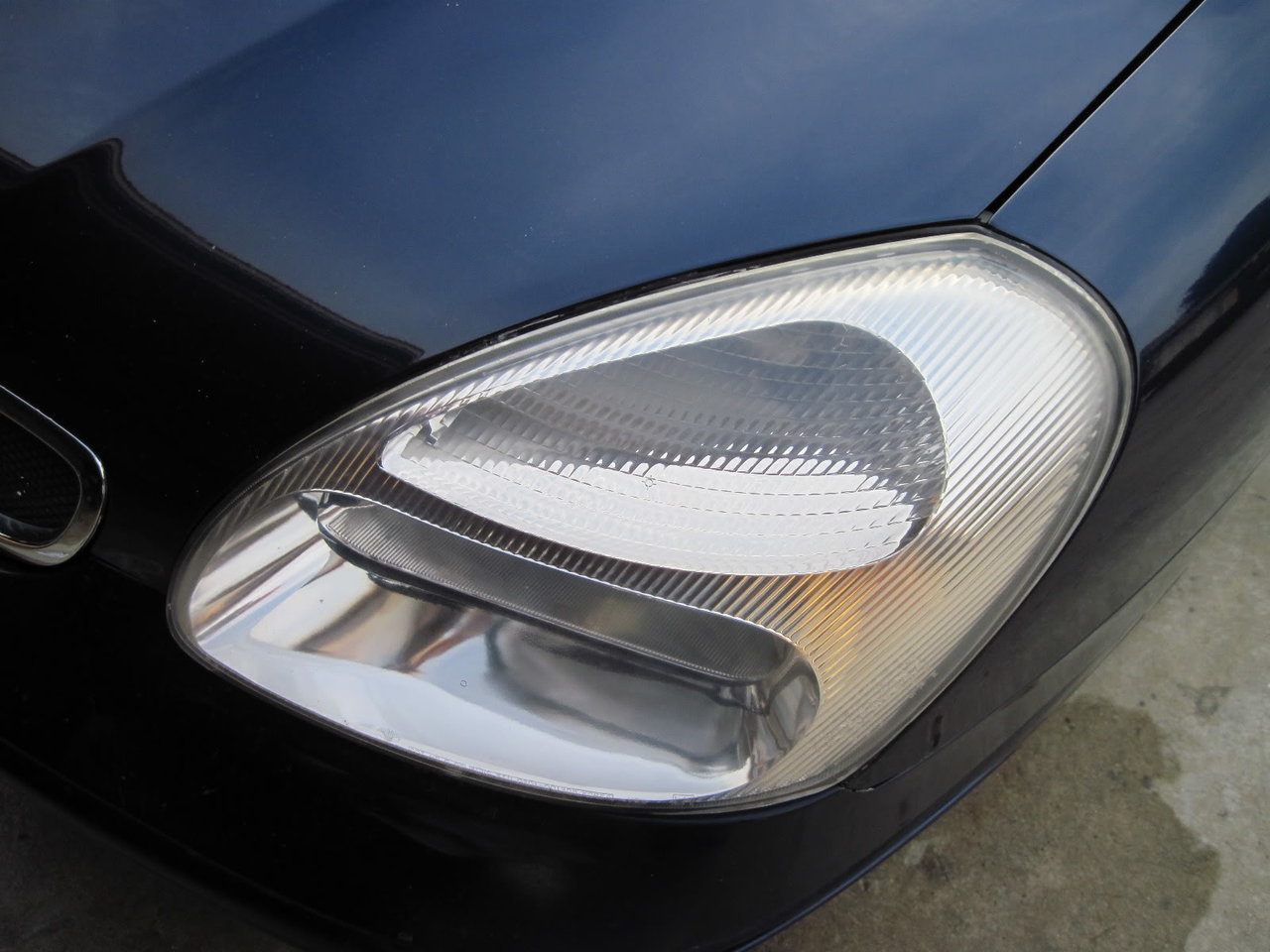

    Not the same headlights as the Tacoma (I used 3M resto kit to restore my originals, but took no pictures)
    But the aftermath of cleaning up my 2001 Daewoo headlamps show the clarity obtainable.
    And honestly... I could have done even better, if I spent a little more time doing it.
    before... (clarity purdy much impaired)
    after the 3M restoration kit clean up... (easy to do if ya can run a power drill)*
    * use masking tape adhered around the headlamp(s)
    to ensure no damage occurs to the surrounding paint when sanding/buffing.
