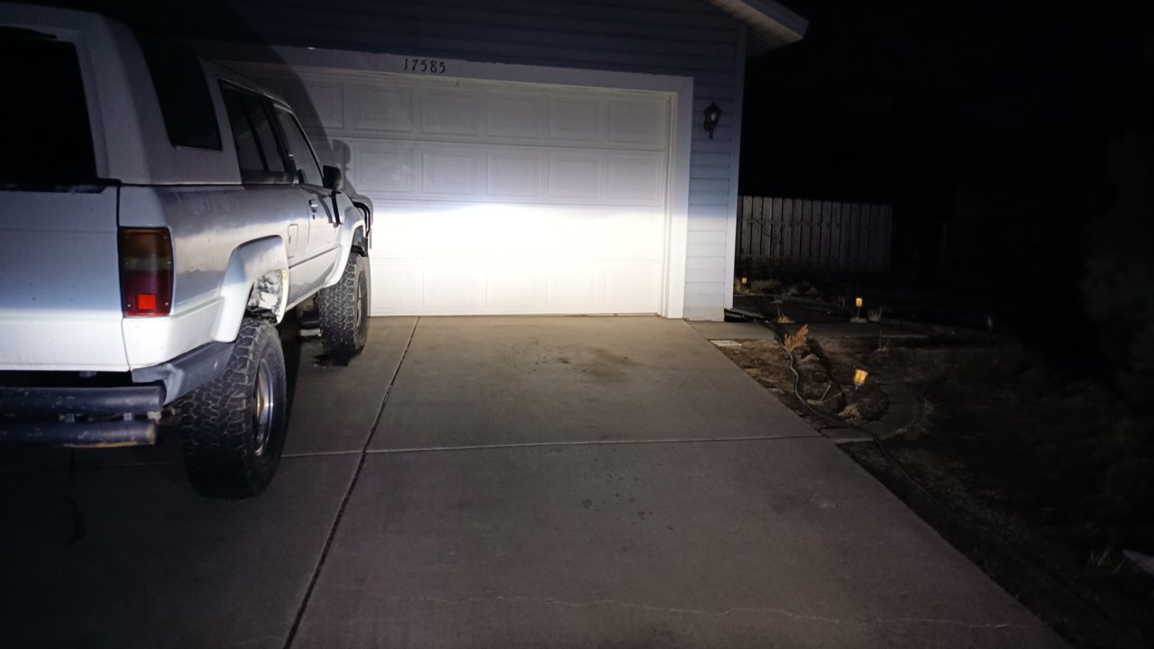

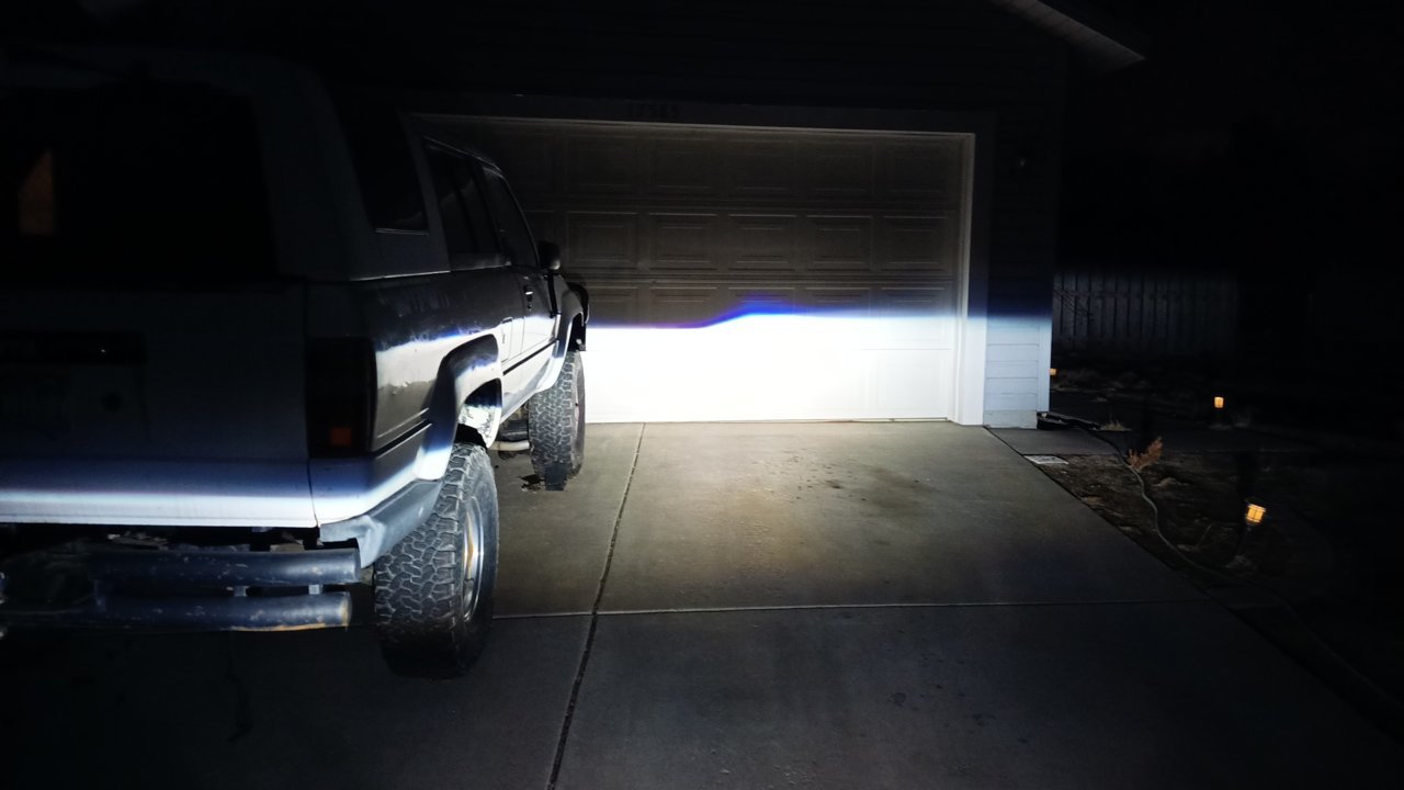

    I saw these photos on one of the larger headlight threads. Its actually what led me to realize that cleaning and some bright bulbs wouldn't be the best solution

    I think I am going with some new housings considering how cheap they are. Is the upgraded wire harness needed for higher Watt bulbs? or are there higher quality bulbs that aren't higher wattage than stock bulbs? I imagine new housing would help a lot, but I wouldn't mind a minor-decent upgrade from stock.
