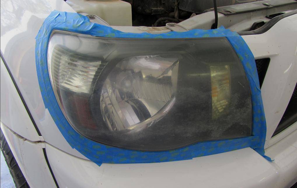

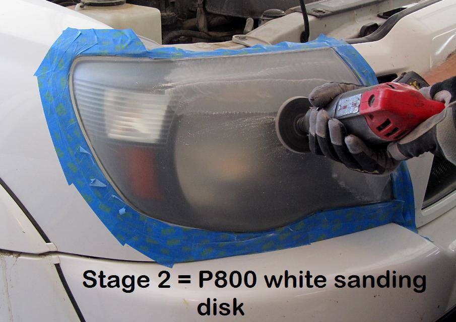

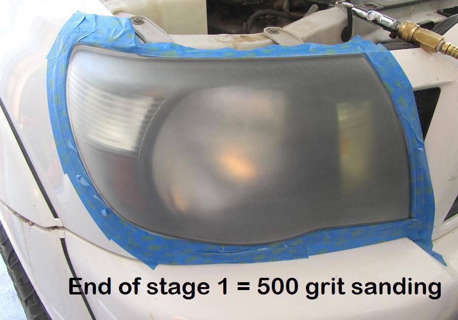

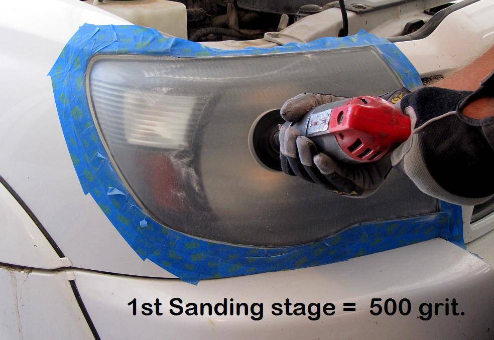

    My headlights on my 05 were getting worse by the day it seemed. I paid about $25 for the 3M Headlight Restoration kit. After letting the kit sit on the workbench for a month, too afraid to take sandpaper and a drill to my headlights, I finally jumped in. I took my time and they came out AWESOME. I can't believe the difference.
    I didn't even read the directions. Instead I went to 3M's website and watched the YouTube video which demonstrates the process, start to finish. www.3mcarcare.com.
    I snapped some pics during the process.
    The kit I used:
    First tape off the area around the headlight to keep from damaging the paint while sanding and buffing.
    Stage One...sanding w/ the orange P500 grit disks.
    End of Stage One Sanding

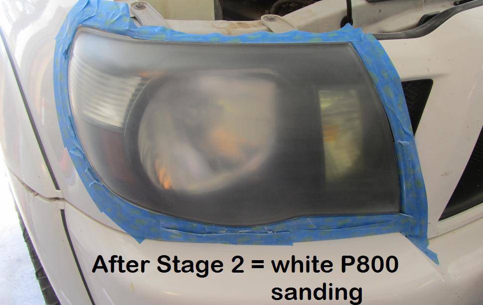

    Stage two sanding...white P800 sanding disks
    End of Stage Two Sanding

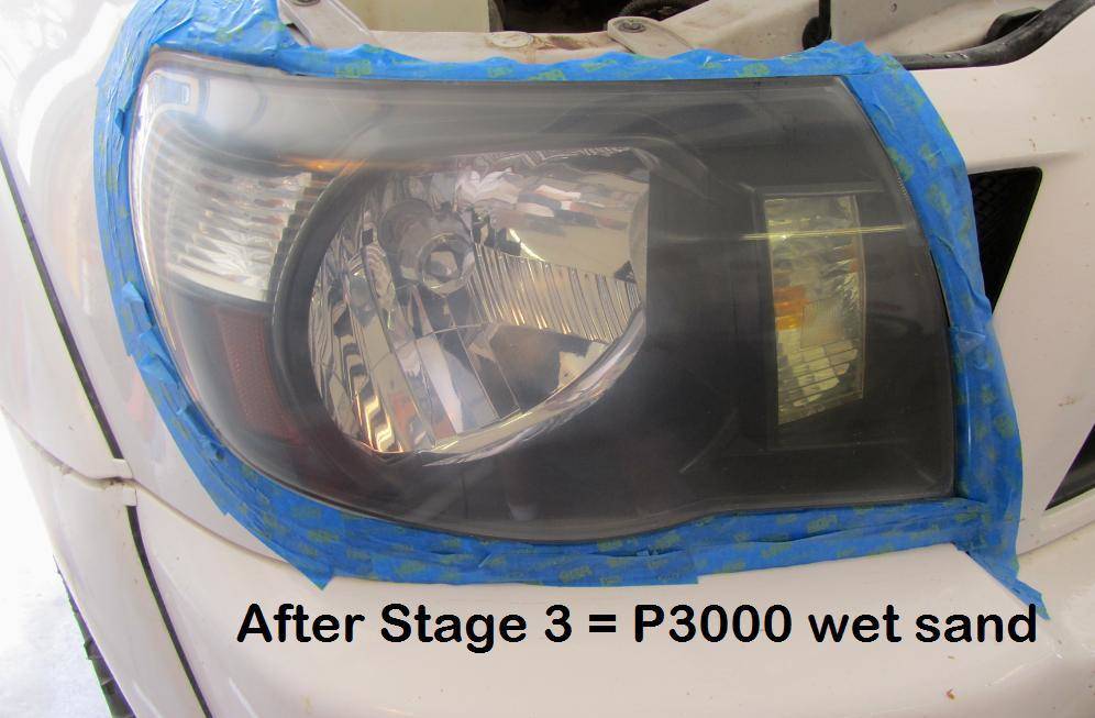

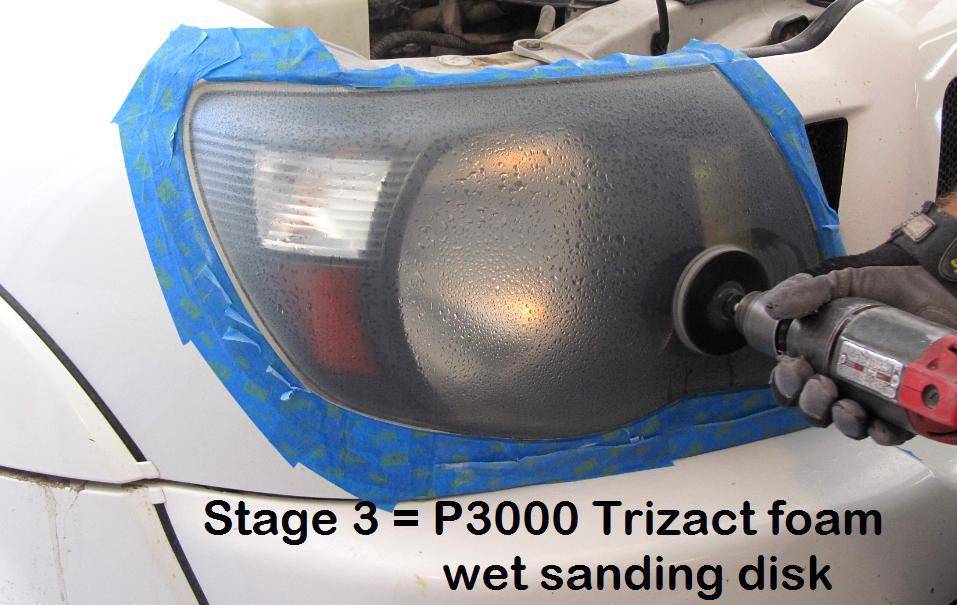

    Stage three sanding...grey foam Trazact 3000 disk
    End of Stage Three Sanding

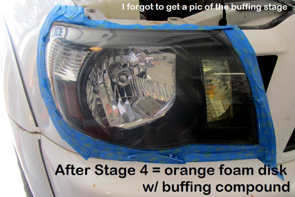

    I didn't snap a pic of Stage four sanding...the orange foam buffing disk with the buffing compound.

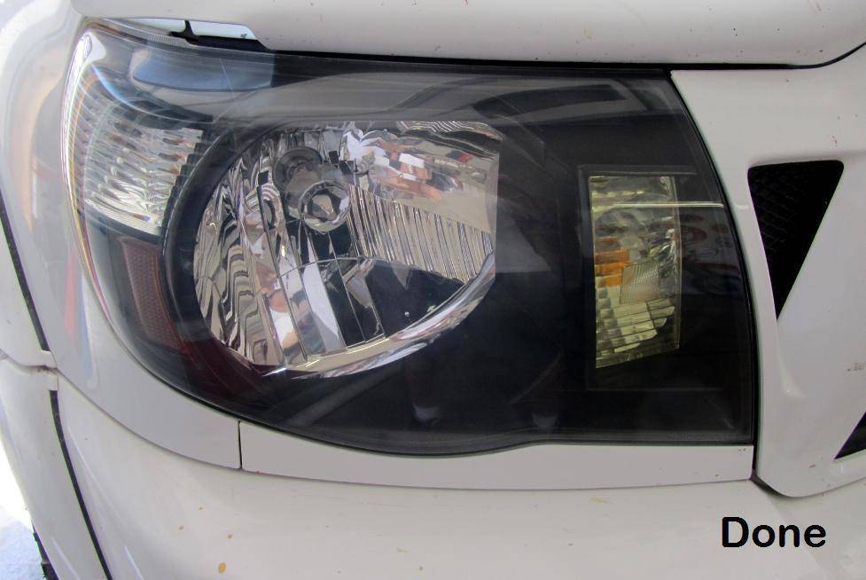

    The headlight after all sanding and buffing are complete.
    The headlight after polishing it w/ Plexus (which I use on my motorcycle windscreen).

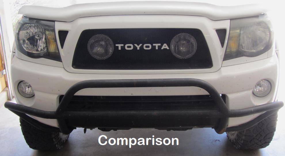

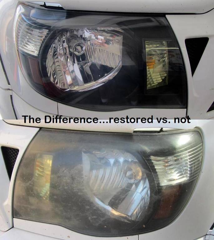

    A couple of comparison shots.
    When you are done, you need to seal the headlight, and keep it sealed, with a good wax afterward to keep the headlight from hazing with time.
    And I can't stress enough looking at the Youtube video for helping with the process.

    Wow!!!!

    wow night and day!

    Looks great. I like to go higher on the wet sand up to as high as 2000 grit. This helps with getting out all of the deeper scratches and making the polishing that much easier.

    4x4, DCSB, Off Road, V6 Tow
    how many passes with each of the disks?

    The wet sand is higher...it's 3000 grit. You can't even feel the grit it's so fine. It seems as though it's polishing the headlight as it works.
