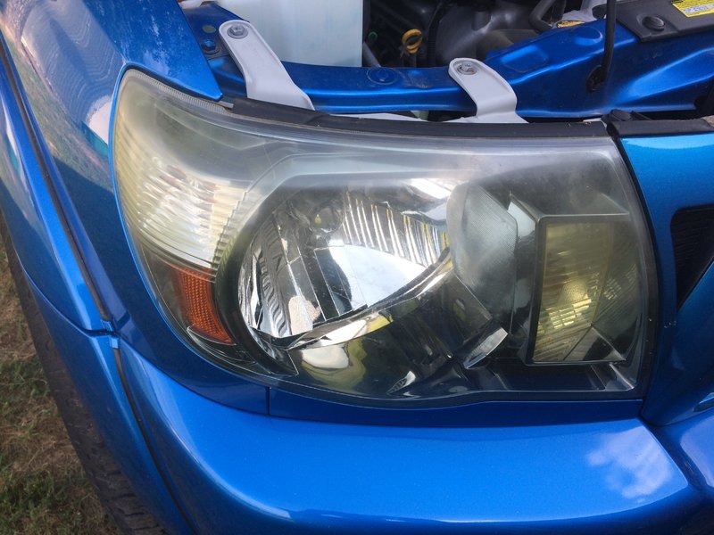

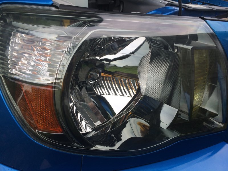

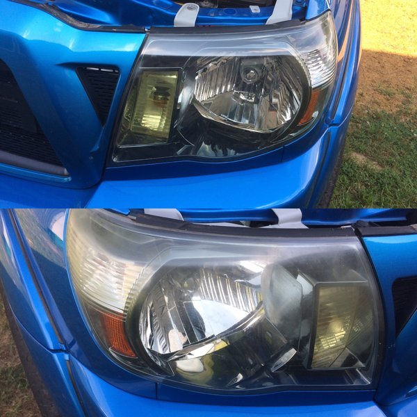

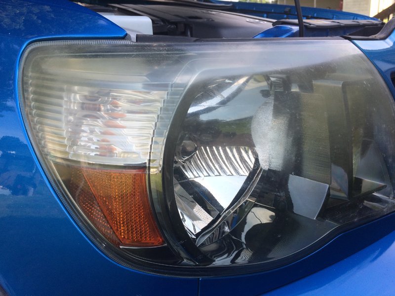

    Starting to see some haziness/oxidation on my 2011 Tacoma. I wanted to use this as opportunity to try out Optimium Opti-lens coating.
    Typically I see this process done with wet sanding. I decided to gamble and use 0000 steel wool followed up by Adam's Correcting polish and Finishing polish. Note* I only used steel wool due to not having sandpaper on hand* Clarity is much improved.

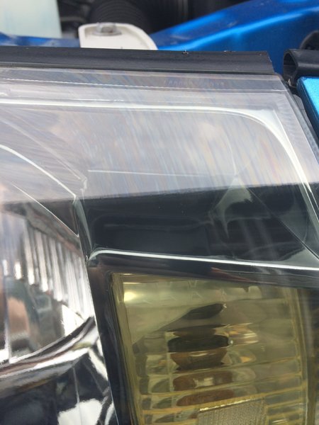

    I used Optimum's paint prep to clean headlights before applying Opti-Lens. Below pic is Opti-Lens starting to flash. It is easy to apply. Let set 3-5 minutes than remove. I put on 2 coats with 5 minute intervals.
    Drivers side restored and a nasty before shot of passenger.
    Will see how Opti-Lens holds up since its listed as a permanent coating. Plan on applying to 2016 4Runner to help slow down the oxidation process.

    Jul 14, 2012

    Quick update. As noted before I had some hazing on the upper portion of each headlight. Using Shine Supply Classic Cut and a TRC eagle edgeless towel, I easily removed the haze. Use Optimum prep to remove residue and re-applied the coating.
    Not sure what caused the haze. Took no effort to remove with little pressure. I am wondering if another product caused the issue. Will report back in a few months.
