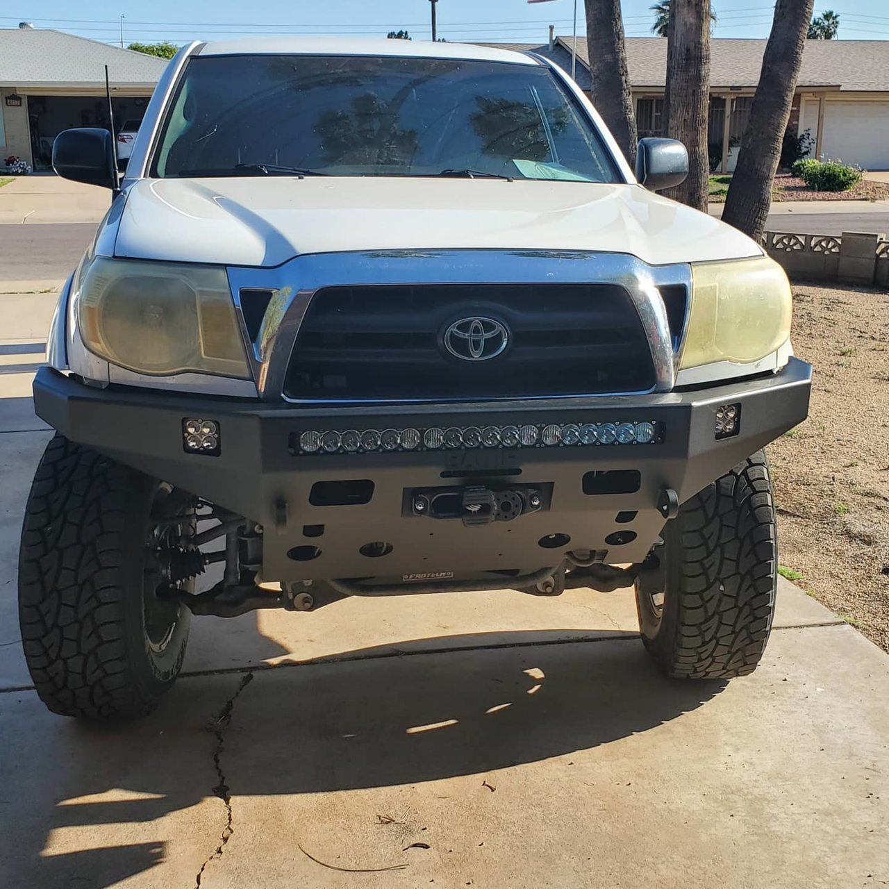

    This in my opinion is the best way to do it, only thing different is id get automotive clear put in a spray can since it has uv protectant then simply take care of them same as your paint.

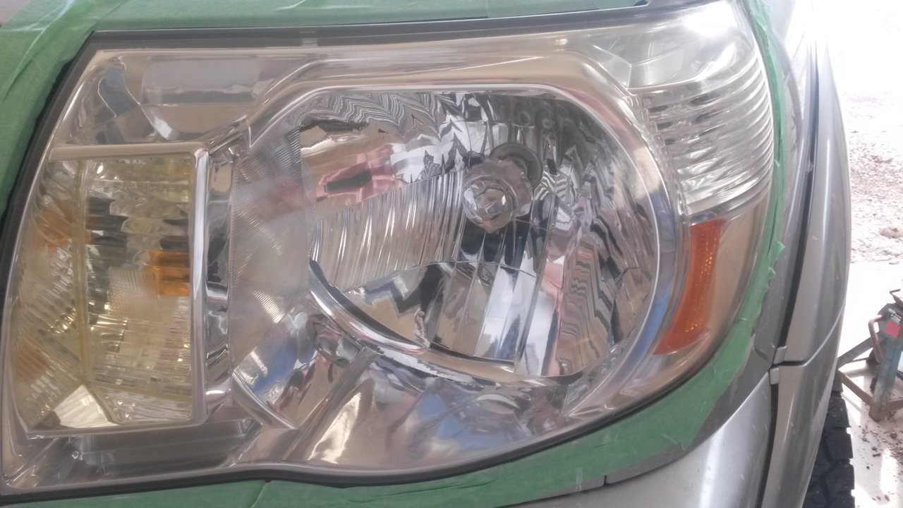

    I have the same Maguires kit. It worked well. I just did the flat surface in front of the light to get me through the winter. Now that the weather is warming up I'll polish the whole lens and spray the uv sealer on. I considered the xpel film but I'm too cheap to spend $82 for the precut kit for both the headlights and fogs. The lamin-x kit is $59 for just the headlights.

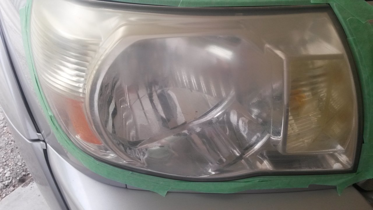

    Mine looked about that bad it should work just fine

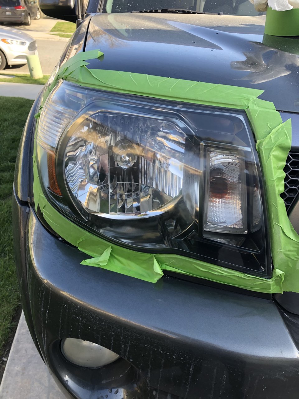

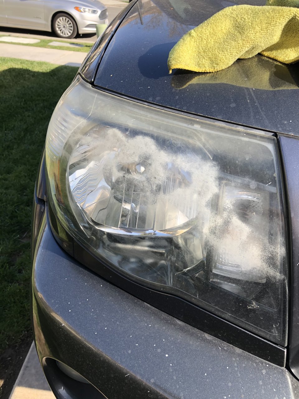

    Here are a few before/after I had saved.
    I’ll try to get some more later of the almost 2 years.
