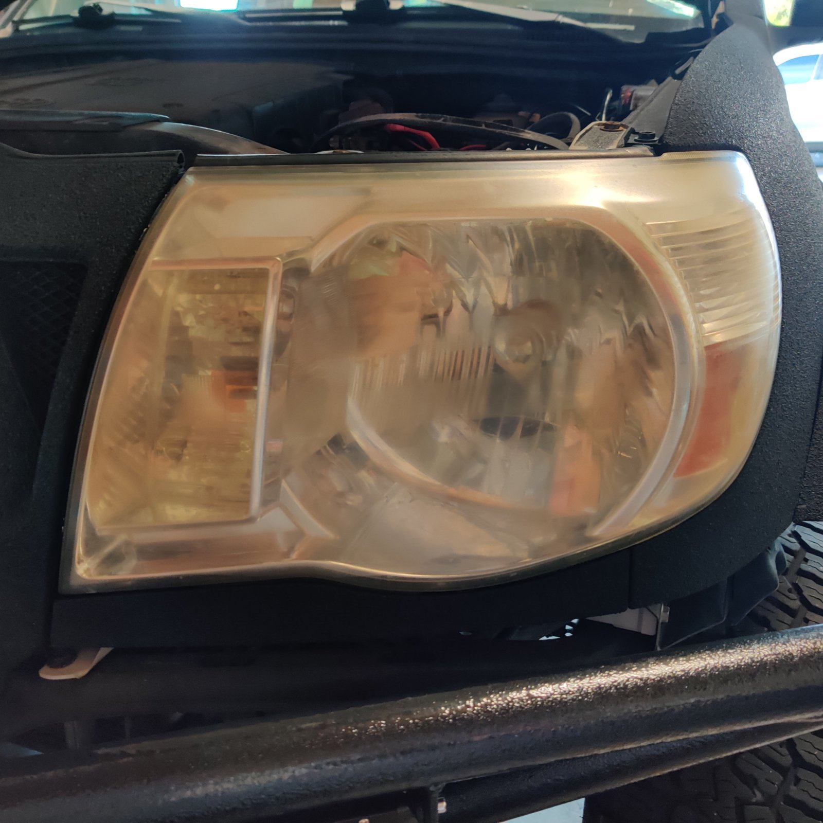

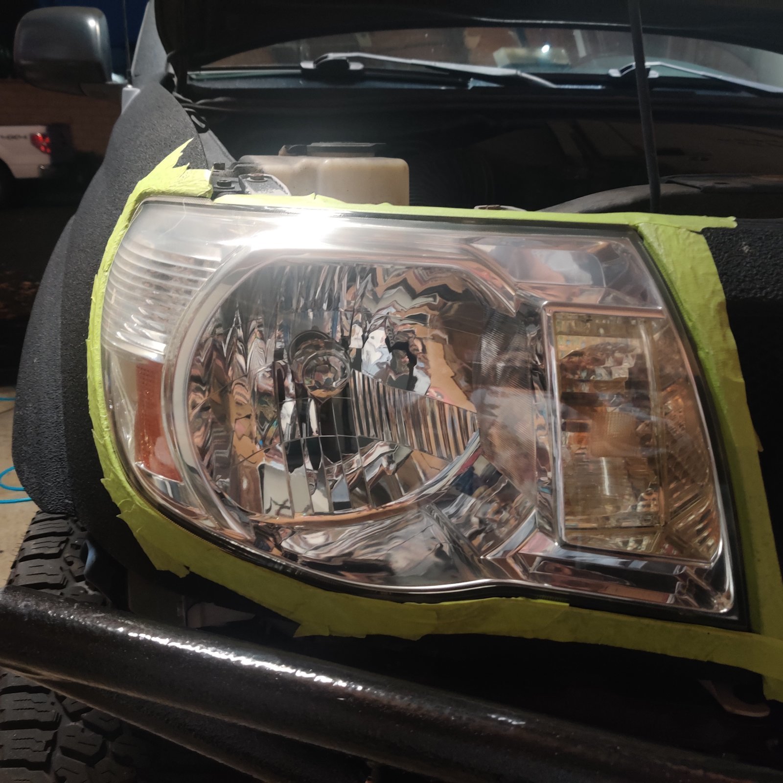

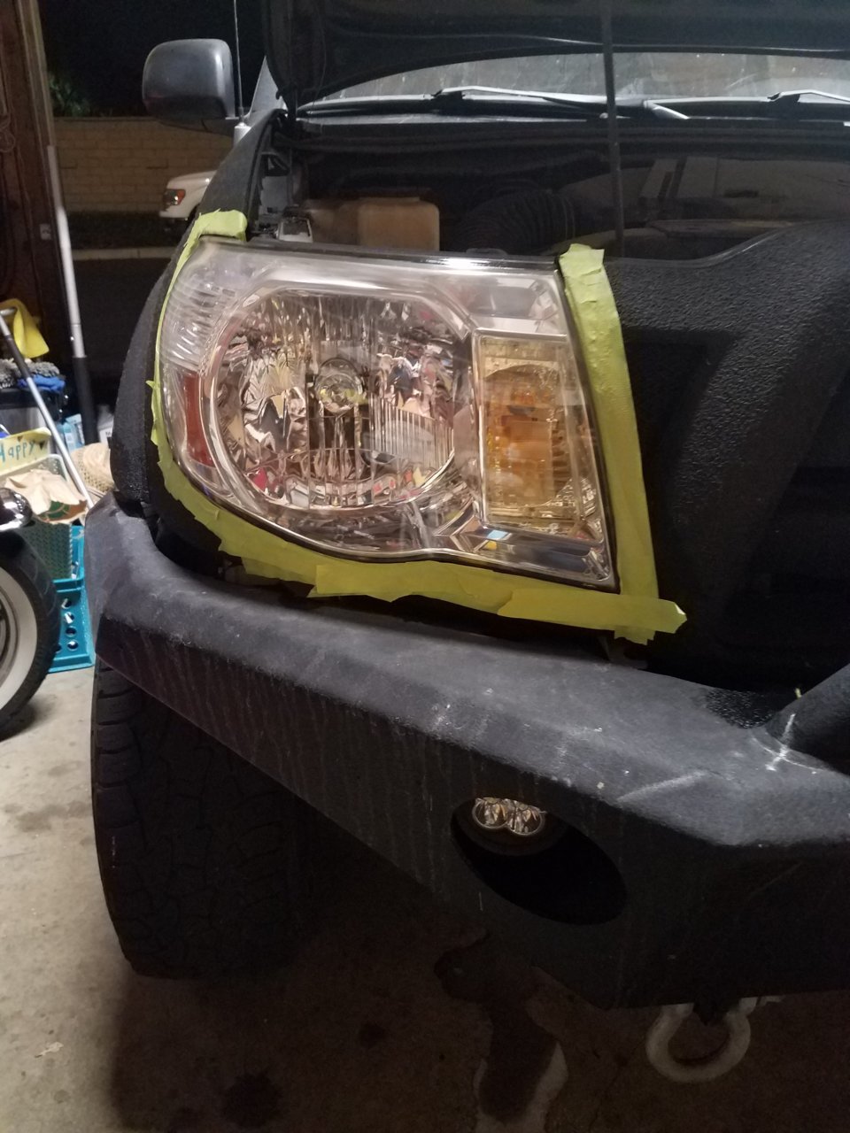

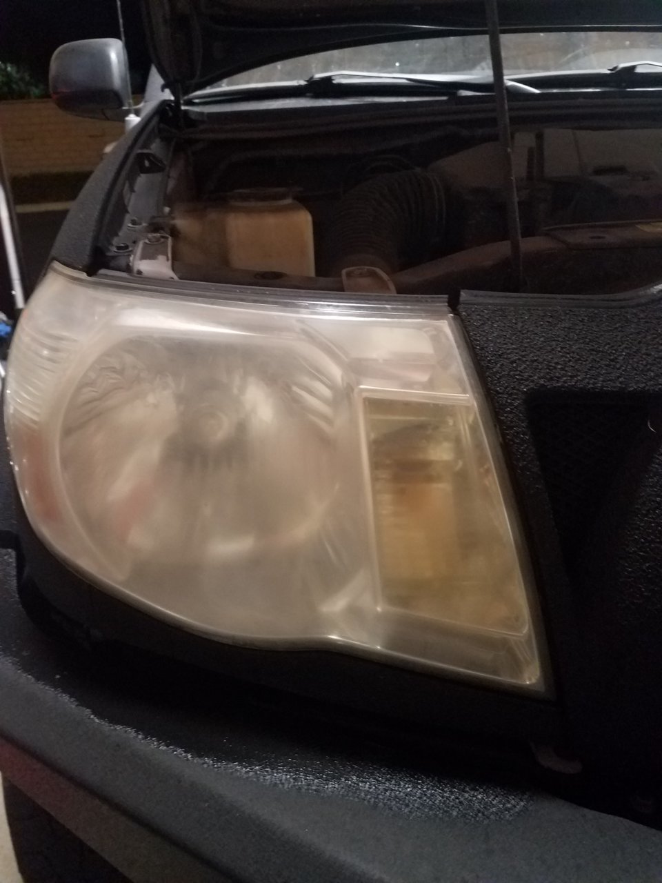

    Before and after pics... this is coming from a 08 as well... hand buffing wasnt cutting it anymore.20220610_213444.jpg 20220610_225529.jpg

    Nice job! I used the same kit you used and think it’s the best (personal opinion). Be sure to use Meguiars clear coat , otherwise the lights will re oxidize in a couple months. I did mine over 3 years and the clear coat keeps them looking like new.

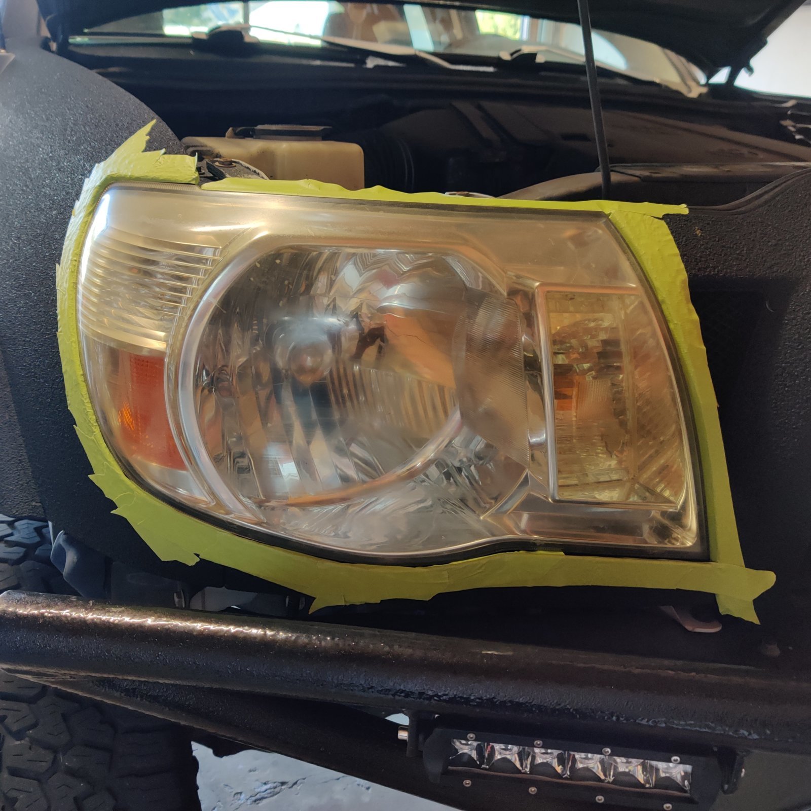

    I used the Cerokote Headlight Resoration Kit today.
    Almost the same amount of preparation, however, since this one is a straight ceramic coating there is more attention to detail (typical with ceramic coatings). Below are my before and afters of Cerakote ...
    - Mcguires in my opinion is easier to use for the first time novice user. There's more room for error that can be easily patched up where as the Cerakote if there are impertfections you don't notice them until it's too late. (There are some light splotches/spottyness on the very top, this kind of goes back to you don't see the small impertfections until its too late)
    - Cerakotes step 3 is wayyyy easier to use than the final step on the Mcguire big kit I used.
    Before Cerakote headlight restoration kit
    After...
    I'll try to reply back after a while to see how long this lasts.

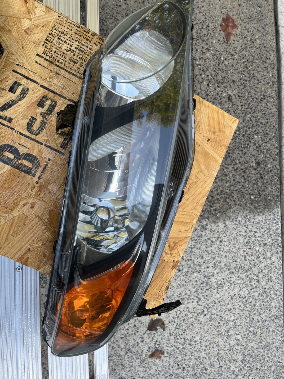

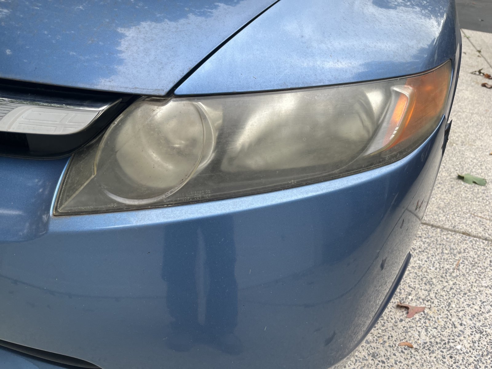

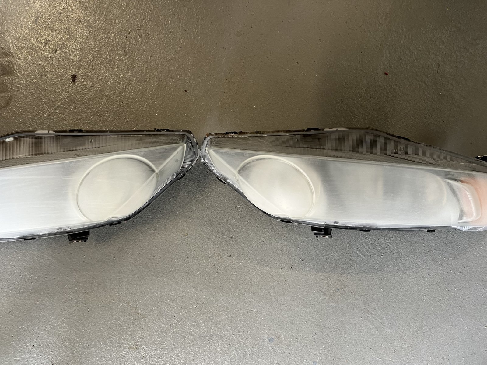

    Wet sand with 400 and get some 2k clear. IMG_4317.jpg IMG_4652.jpg IMG_4657.jpg IMG_4856.jpg
  18. Feb 15, 2024 at 5:33 PM
    #38
    JuiceBox1855
    JuiceBox1855 Active Member
    Jan 3, 2023
    #414643
    32
    2015 Tacoma
    Did you use a headlight/polycarbonate specific clear?
