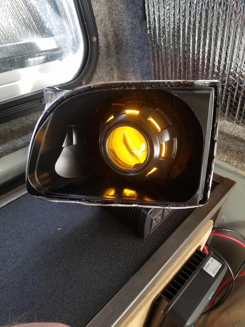

    Did you do RGB halos?
    Demon eyes?

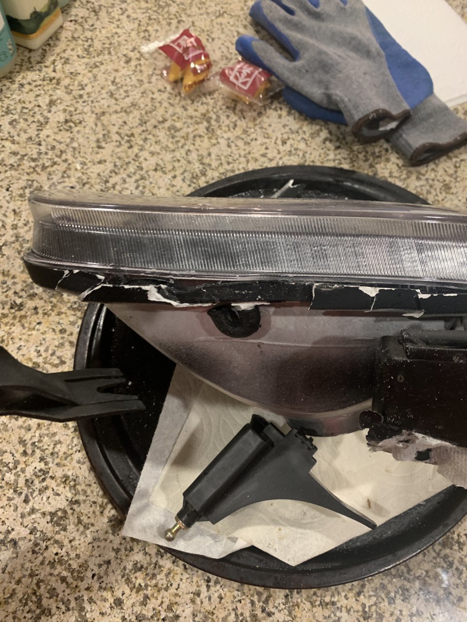

    This aftermarket headlight sucks!

    What temp were you working at and how long? I usually do 225° for 5 minute intervals a headlight at a time.

    Did to get hot enough?

    Judging by the lens warping I'd say too hot too fast. Or is that the normal shape? never really seen that year headlight.

    Yep..broken all to hell.
    Used the right tool and followed the video on TRS
    Hoping it’s just the cheap buckets I bought on Amazon (Not TYC) Heard TYC work well

    Followed the TRS instructions the first time... Wouldn’t budge
    So you’re right I did crank up the heat because I got frustrated. I think housings are just crap
    Cheap

    oh yeah, those may be sealed with permaseal. TRS makes something that supposedly dissolves it. Other than that, those are a real bitch to open up. Most are just silicone sealed, so it's usually really easy.
    Try this, or buy some TYC housings.
    https://www.theretrofitsource.com/morimoto-permatrator-solution-for-permaseal-B-PERMA?quantity=1

    I did eagle eyes headlights. 280 temp for 8 min. I did crack the housing a little on both, but nothing like that.

    This process might not work for an all plastic housing,
    But good info for the 7x6 Metal and glass buckets.
    I have the 7x6 1st gen lights and bought the replacement metal and glass headlight buckets.
    What I did is place the headlights upside down and filled them with acetone and placed them in a tub overnight.
    The acetone dissolved 100 percent of the sealant and the glass lens fell right out of the bucket.
    This was so simply while others were chipping the glass lens trying to pull it out.
    Pushing the lens from the inside with the back of a screw driver with a cloth as protection or a 10” socket extension would be a better option instead of trying to grab the edges from the front lip I think.
    If the buckets you have were glued tho from factory nothing will help
