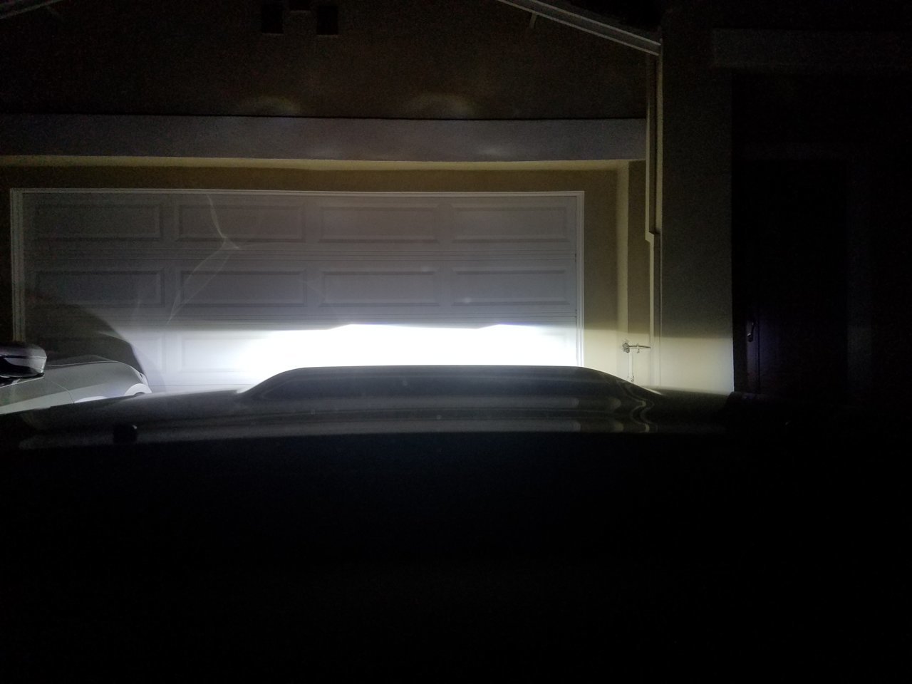

    Go with the Morimoto M-LED BI LED setup. Quick easy money.

    Thats what I was looking at initially because of a thread on here. But it's a huge price difference. How does the led compare to hid?

    The lux output is pretty close to HID from what I remember. I have been very happy with the output and feel like I'm driving a Mercedes or BMW. Hahaha.
