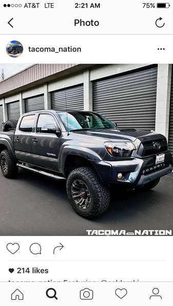

    Hey looking for some headlights for my mag gray 2nd gen. My others got busted. Id like to see some pics of different headlight on the magnetic gray 2nd gen. Im in college and not trying to spend a million dollars either. Can anyone tell me what kind of headlights are in the photo i posted in this thread?

    Looks like OEM BLHM

    Fucking look it up
    Black headlight mod

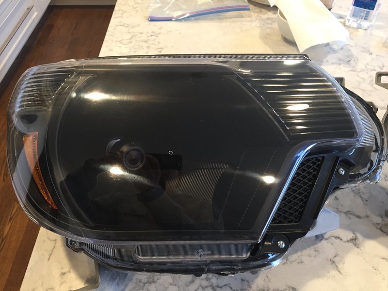

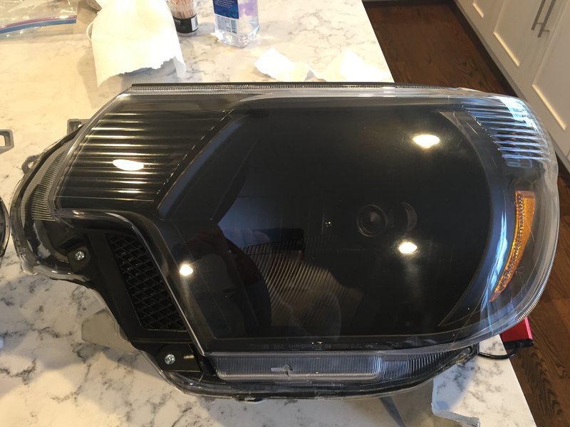

    Bowls Painted.

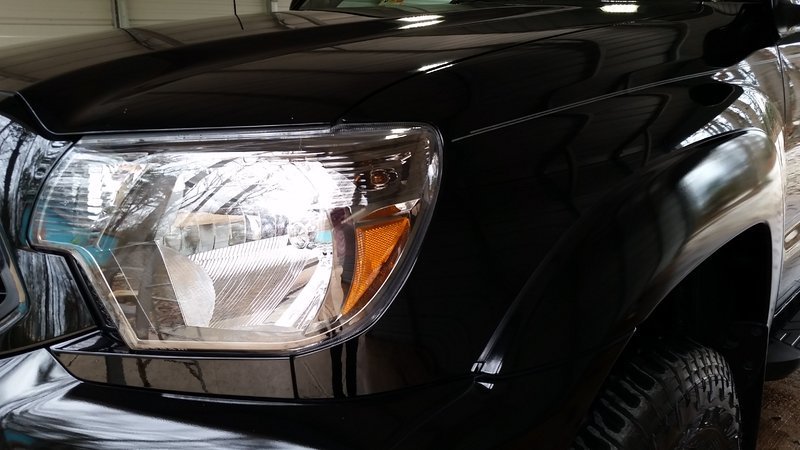

    are you going to retrofit? Not sure if the OEM lights would work with a painted reflective bowl.

    If he plans to use the halogen lights still then yes he would need to keep the bowl chrome so the mirror affect of it would still work. If he decided to install projectors then he could paint the bowl and everything else black as the projector would be the sole light source.

    Plan was to retrofit but I got a good deal on Trd Pro headlights and decided not to.
