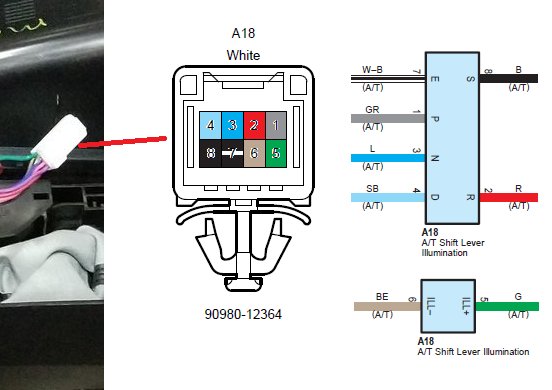

    I put my switch in the center button panel (which is a chore). The seats positive and the "on" wire from the switch are wired into the cigarette lighter positive wire. The ground is connected to the geound on top of my AC converter under the center box and the other wire with the Japanese writing is the illumination wire and I tied that into the green wire on the shift indicator harness mentioned above.

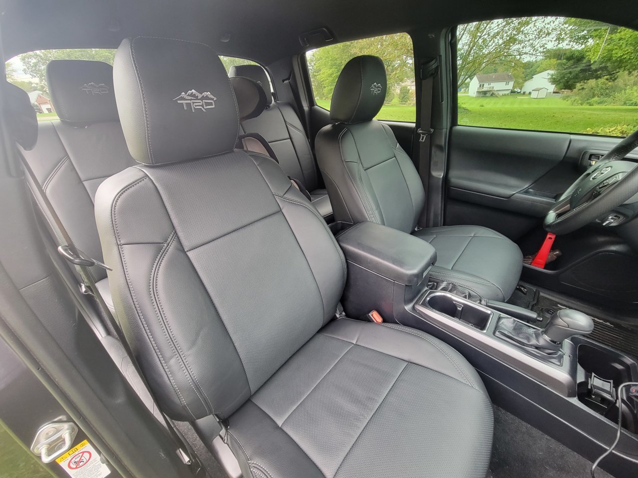

    My only complaint is that the illumination from the clazzio dual switch is very bright and green. Not a dull blue like the rest of the switches.

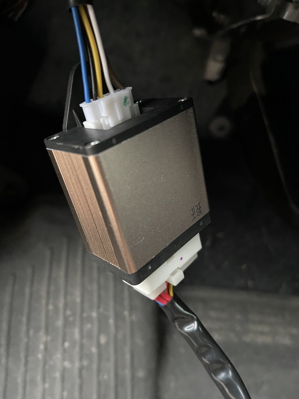

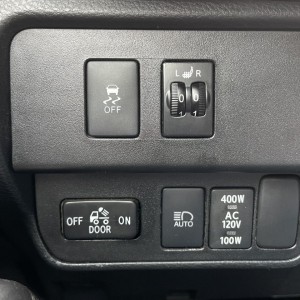

    I think I'm going to take some time this weekend & wire it up the same way you did. Did yours come with this relay box thing that connects the switch wires to the seat wires? There are actual attachments that just plug into the pads from the seats, I got the single panel with 2 dials on it — one for driver & other for passenger. I actually decided to put it on the left side of the steering wheel for that exact reason, the illumination colors won't match & nobody else will see them if they're tucked away next to the steering wheel lol.

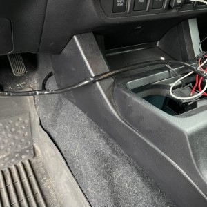

    I've literally been driving around for a couple weeks with the wires like this — not fully hanging like this, they're usually taped up but I had to pull them down to get a picture of that relay box thing. Here's a pic of the box & one of how the wires are just sitting there in the cup holder for now lol

    My harness looked different. I got two identical harnesses. Each had 2 standard relays. There were inline connectors to split off the main harness for a run to the seats and another run from the main harness to the switch. I imagine yours will be easier to install if everything is on the left side of the steering wheel since the fuse panel is right there and the rubber boot through the firewall is right there. The downside will be that you have to help your passenger adjust their temps. I also find the switches down there hard to find without looking. My garage door opener button is there and I always have to stop and look down for it.
    I always remind people, when you add the add a fuse, remember that the orientation matters for plugging it into a slot. You have to figure out which side is hot without a fuse installed on your fuse panel. The add a fuse is only to power the relays, the high power lines should run to the battery.

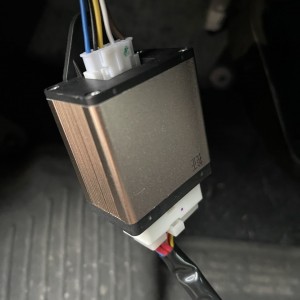

    Mine actually showed up with an add a fuse on both the constant power & the switched power wires. I rarely have anyone in my truck other than my dog, so I figured it would be easier to just get the single panel with both dials on it, but it looks like not many people here seem to use that one lol. Here's what the wires look like, you can see both red wires have different types of add a fuses on them already. The other pic is just where I put my switch.
    [​IMG][​IMG]

    Yes that's the switch I have and the little relay box. Looks the same.
