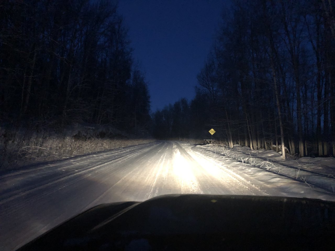

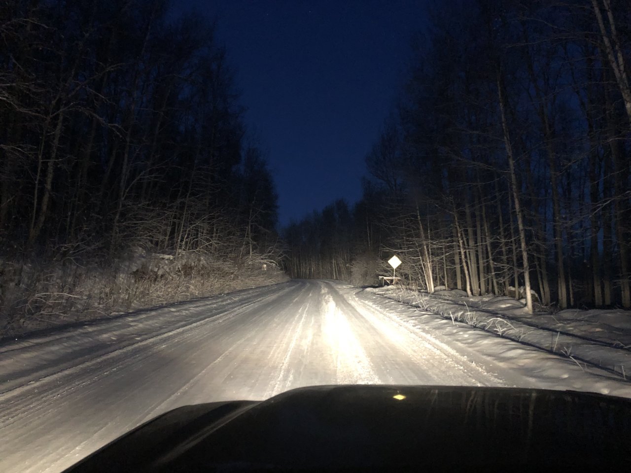

    You can choose to see better or look better affordable, but to do both it’s gonna cost a lot of money.
    C10472D6-613E-4219-916C-27D873468202.jpg AFAFFB4D-01DB-4ADE-8350-7780B5F9F360.jpg
    Just lows
    With high beams, from the same spot.
    r1200gs4ok likes this.

    skierd, which bulbs do you have in the pics? They look very good.
  11. Jan 15, 2019 at 6:23 PM
    #191
    skierd
    skierd Well-Known Member
    Mar 11, 2018
    #247038
    1,224
    David
    Fairbanks, AK
    2021 F150 XL STX Screw 4x4 2.7
    GE +130’s for lows, stock high beams, headlights aimed up 1/2” or so
    crashnburn80 and volscrazy65 like this.

    Is that stock wiring? or with relays?

    Stock wiring
