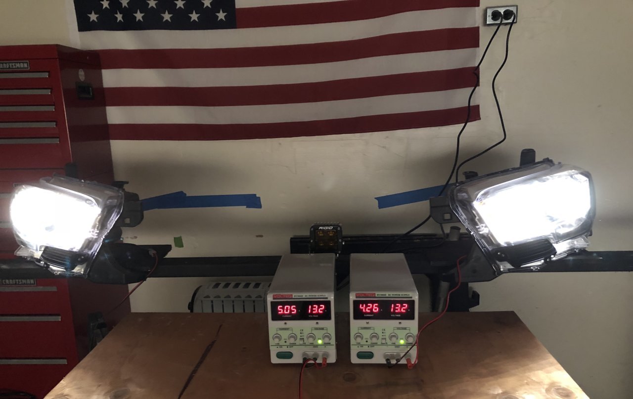

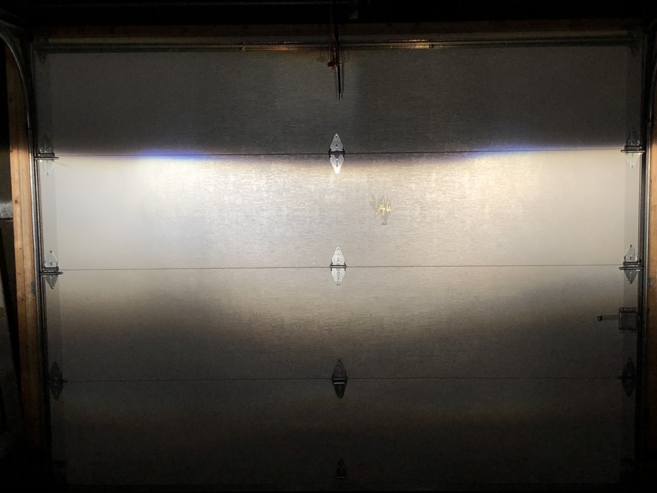

    H11 GE Megalight +130 left vs H9 Volsa right
    Lux pattern readings:
    Hotspot: GE 984 vs vs Volsa 784
    Mid-beam GE Mid-400s vs Volsa mid-high 300s
    Low-beam GE ~180s vs Volsa ~high 190s
    Color: GE 3500k vs Volsa 3200k
    Volsa H9 left vs GE H11 right
    You can see the Volsa consumes ~67w and the GE ~56w.
    Bumping voltage by 0.4v to 13.6 to simulate gains using a standalone harness results in the GE hot spot intensity pushed to 1142 lux, which is about a 16% gain in output.
    I see no reason to run an H9 when a stock wattage high performance plug and play halogen produces significantly more distance projection intensity, and mid range intensity. While the H9s do better in short range the difference is minor and vastly outweighed by the gains in projection compared to a performance halogen.
