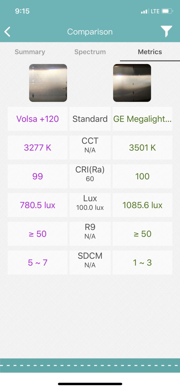

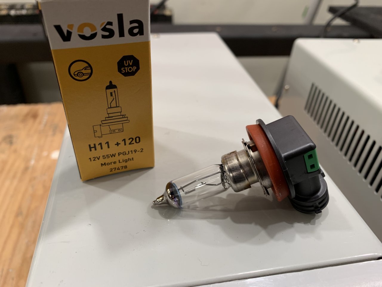

    Always wanting to test the latest and greatest, I ordered the latest recently released performance +120 bulbs from Volsa to compare to the GEs.
    Volsa +120
    GE +130 vs Volsa +120
    Output measurements
    While the Volsa bulbs are a good improvement, the GE +130 bulbs continue to provide the best output.

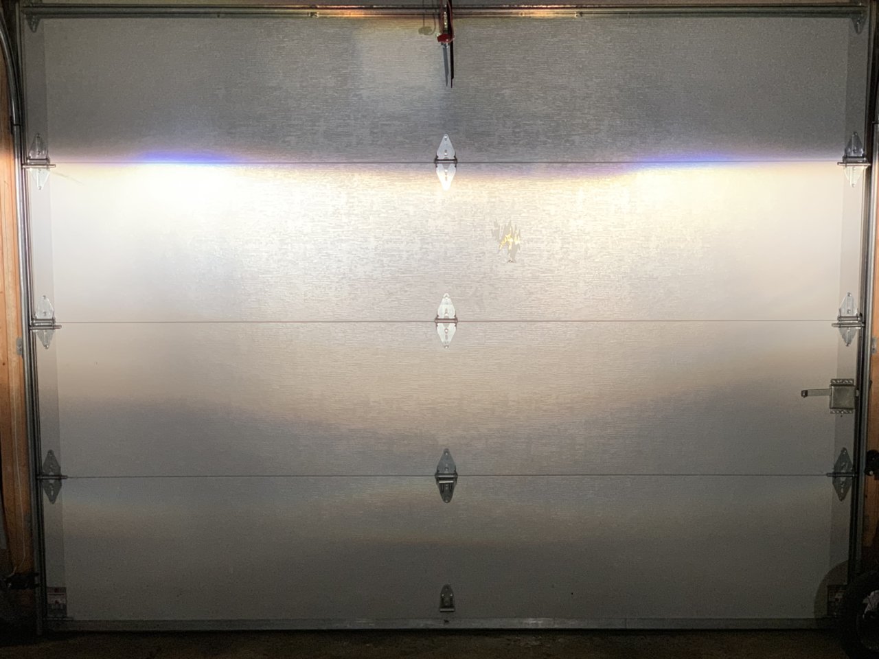

    No I have not switched sides , but yes I pulled up to a flat wall and you definitely can tell the difference .At first I thought I might have it crooked when I twist locked it in but that was not the case . H9 Are what the 3rd gen High beams are correct or are they H11 Also.

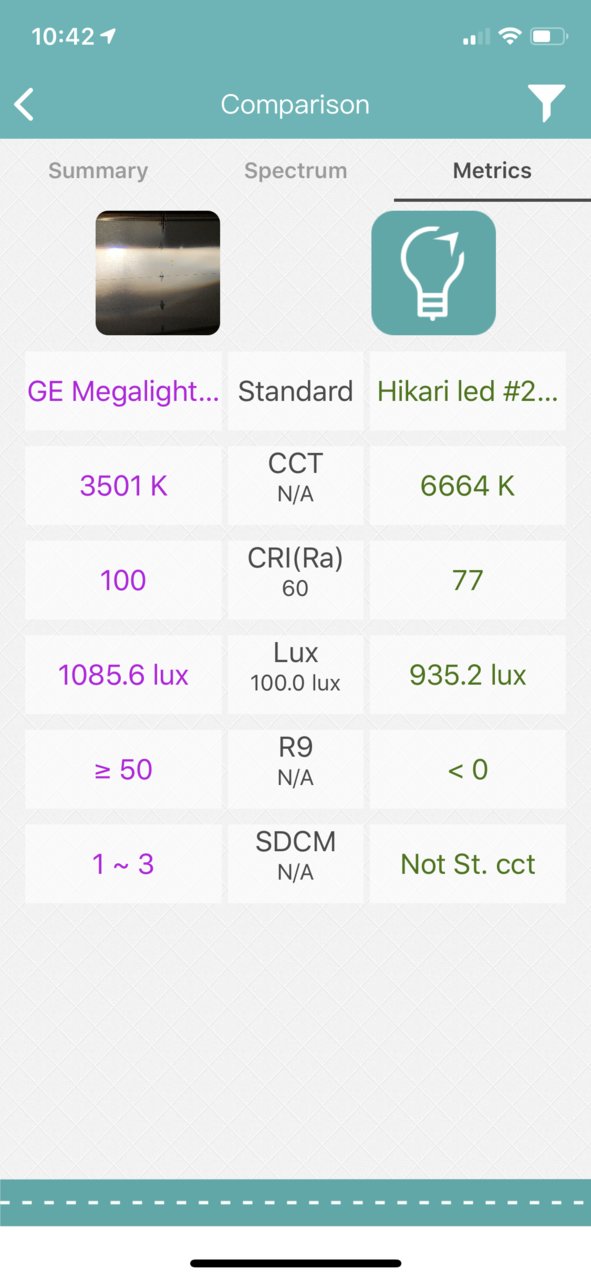

    I used Hikari, wasn’t sure about which brand to trust. These however have been fantastic. Tons of light at short to medium distance on the freeway. Out in the open when it’s just truck light, they are great. Had HIDs before. Not bad, but not my fav. LEDs for me from here on out.

    I’ve tested those too. They are the best performing LED I’ve tried, though the quality seems very questionable. But the GEs still do better, have better focus, more consistent beam, and will project further.
