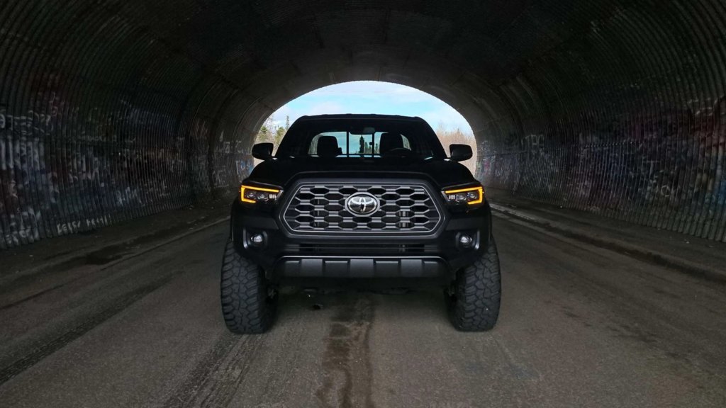

    the morimotos are simply the best option. but. your obviously paying for that premium. i went with them over the oem leds because with the optional superchargers the high beam pattern is amazing. the heated lenses melt snow off in the winter where the oem leds can ice over. plus i just like the look of them. i have them paired with the matching evo foglights and i couldn't ask for any better lighting without adding auxiliary lighting
