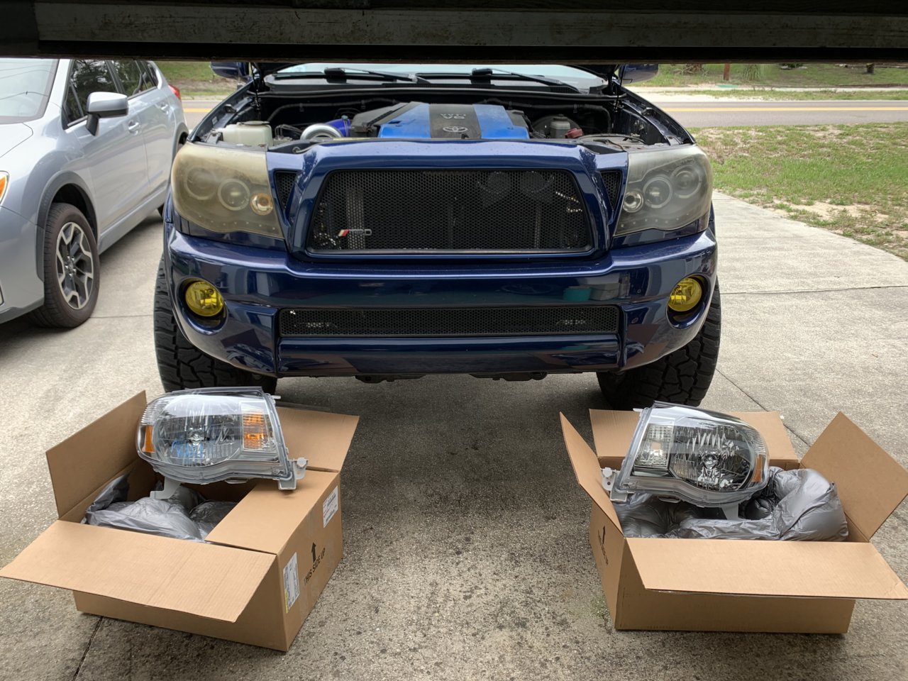

    OEM is expensive and they are old looking. I just got a set of LED DRL No name brand Taiwan made from Extreme Terrain, They are kinda shitty to be honest but I do like the look of them a lot. I'll try them till they fail.....
    People talk about TYC off Rock Auto....I wonder which set is better
    TYC 20657800SET Set; Includes Bulbs and Sockets
    Left & Right; Base Model; w/o Sport Package; Type 2
    or
    TYC 20657890SET Includes Bulb & Socket
    Fits Left & Right; Crew Cab Pickup; Standard Cab Pickup; Pre Runner; w/ Sport Package; Type 1
    or Left & Right; Extended Cab Pickup; Pre Runner; X-Runner; w/ Sport Package; Type 1
    This is what I got

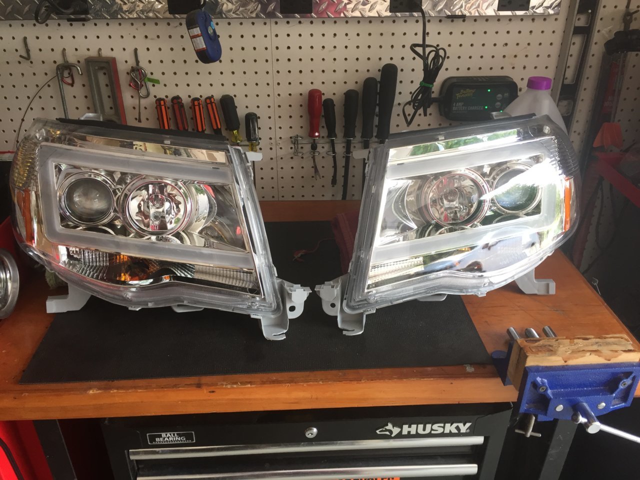

    Just installed these OEM smoked headlights on my 07 (came on the 09-2011 Sport but will fit the 2005-2011 Sport and Offroad. Got them online from Boch Toyota South... OEM part# 81150-04173 / 81110-14173.

    I have the 15 TRD Pro version of these, can’t go wrong with the OEM smoked/chrome delete look:thumbsup:

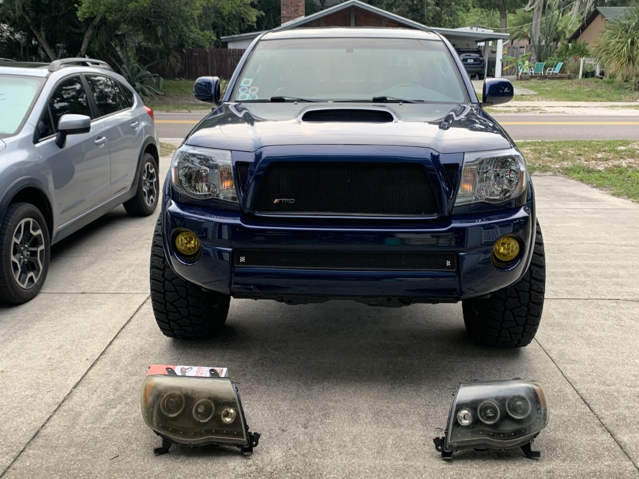

    Having purchased some Spyder "projectors" a few year back, they faded and yellow'd weeks to a month out of warranty. I forgot which on-liner I threw away my money to, but they were only happy enough to offer me a discount on a new set... (insert your favorite FU emoji here)
    I then tied completely sanding down and clear painting back, ect... which lasted another year maybe, and back to shit....
    Unless you really want that look by going full Custom (too bad BX Built went caput....) Buy OEM.
    Just show your dealer the price on line at any of the on-liners, and your dealer should give you a pretty good deal right there and can have them the next day.
    Buy once, Cry once...
    I performed the Post #3 above, and also did the same as Post #14... got to improve the early 2nd gen look some! (I'm 2006)
    I went with this Osram NB 200 and I'm super impressed with the result.
    That said, (PM'ing with @crashnburn80 ) "Philips Racing Vision +200s are better. With the wiring harness the Osram Superbright 100/90w are better still."
    Good luck and have fun!
