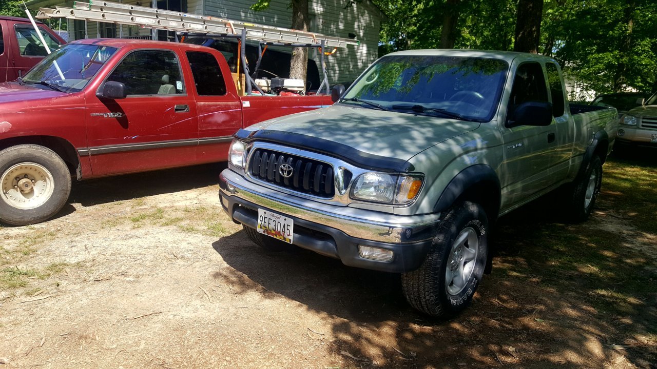

    I recommend cerakote headlight restore. I used it on my 04 and they made the headlights look brand new again. A year later, they still look new. 17 dollar kit from their website or Amazon. Takes about 20 minutes to do.

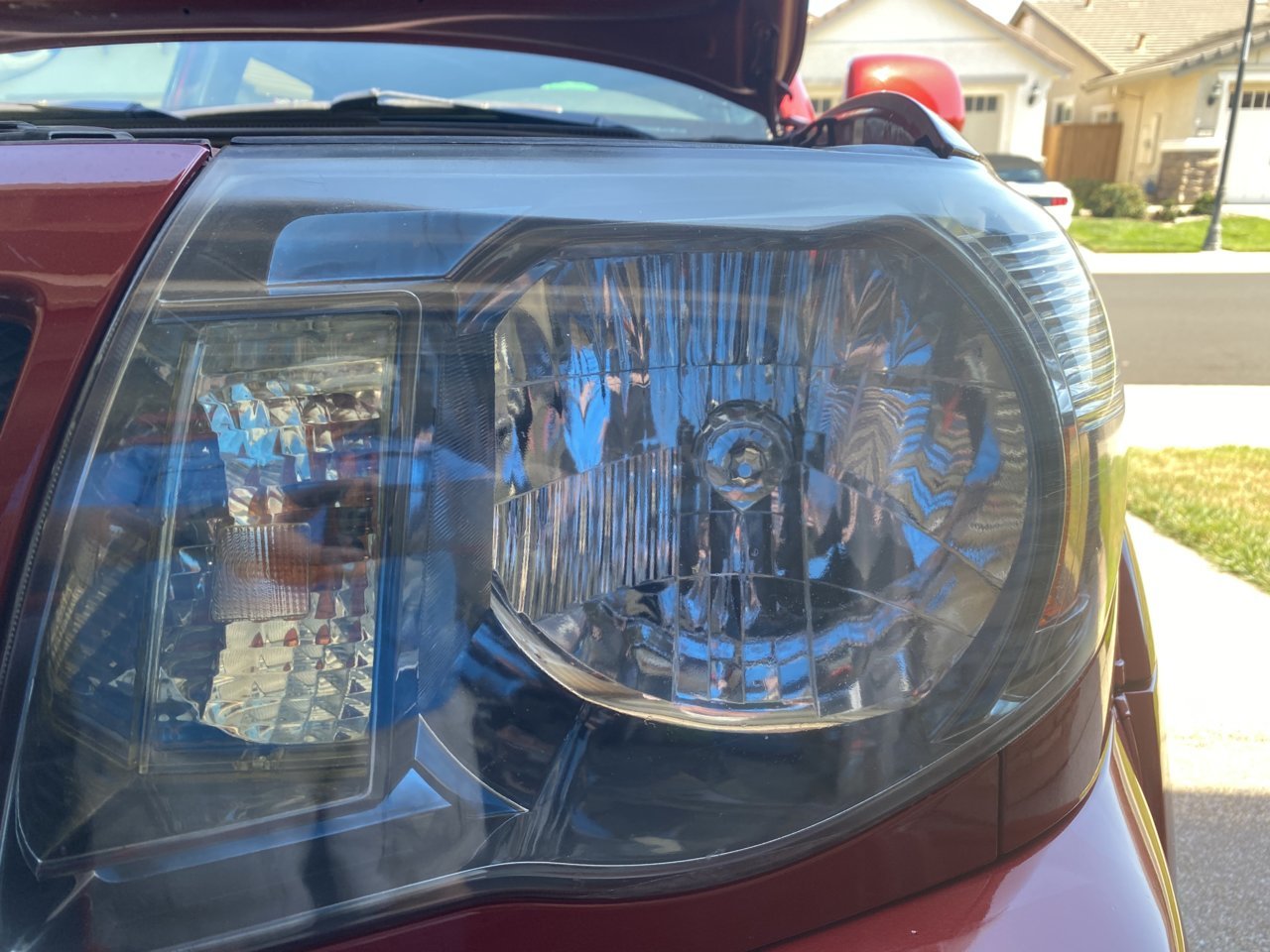

    FCE118B5-827E-4607-A312-9A7791AC01D7.jpg The secret to keeping the lens clear after you’ve polished them so they stay clear is applying a UV protectant. If you don’t they will cloud up again after a few months. I did mine a couple years ago and apply UV protectant (easy, just spray it on) about every 6 months. They continue to stay clear and look like new. You can get new ones if you want but can save a lot of $$$ by doing what I do. The truck and lights are 12 years old and the truck is not garaged. And my lights were really hazy before I cleaned them up.

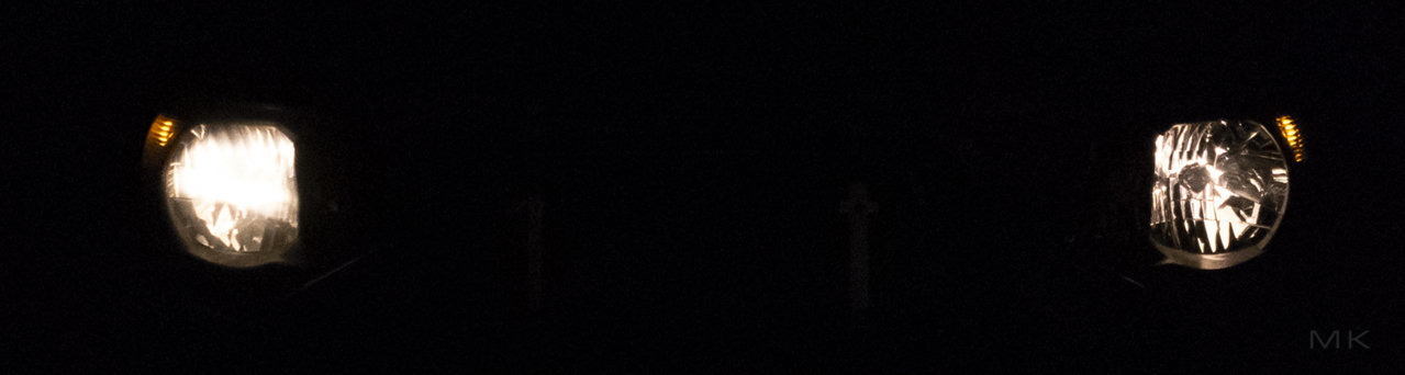

    Don't waste time and money on "restoration" products for 15+ year old headlamps.
    Just buy new ones. OEM is best, but I went with (I think) Depos. Crystal clear,, and beam structure is perfect. 18 months in and they still look 1000x better than the best I ever achieved with a handful of "restoring" products.
    All the money I spent on restoration kits would have paid for the new housings.
    It's not that restoration doesn't improve things--it does. So much in fact that they'll look "like new" by comparison.
    Last summer I broke one of my headlights, so I finally shelled out for a pair of new housings. As a test, I super-duper restored one of the old housings, to test side by side with a new one. Half an hour spent prepping and polishing... three pastes, two drill attachments, and a particularly expensive polishing protectant. And I was positive my work looked factory new.
    But wow it wasn't even close. New housings win, 100%, final answer.
    And they won't turn yellow in 3 months either. No maintenance needed, no protectants necessary... they are literally new plastic. Not 15+ year old plastic.
    So, just buy new housings. To quote @TacoTuesday1 :
    Edit: here is side by side "restored" vs new:

    I'm not going to argue with your pictures. What you are showing there is that over time, the reflectors oxidize too, and those are all but impossible to remove, restore and re-install. So yes, you do get to a point where polishing / restoring lenses no longer gets you back to full performance levels.
    What I will take issue with is your logic. One cannot tell how good a headlight is by looking into it. The only real test is a flat wall about 25 feet away. This will show the true pattern the light puts out. Many people take pictures of their lights while facing them to "prove" how bright they are. I could blind you with a $3.00 LED flashlight aimed correctly at your eyes. But how effective would it be as a headlight?
    Do you have pictures of the same side by side OEM vs Depo headlights up against a wall? I'm willing to bet (based on personal experience) that there is a significant difference in the pattern even though the lights look almost identical.

    Hmmm, interesting. Too bad the embossed pattern in the garage door hides the exact details of the patterns.

    Yeah, I didn't have a big enough screen, gotta work with what you got. The new housings do really work better than the old ones for me, better focused at distance, crisper cutoff, and less glare in rain or dust! Can't compare the Depos to new OEM though--those were beyond my budget!
