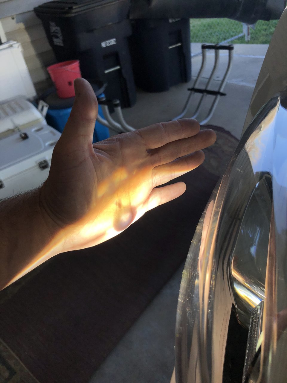

    Hello, i just installed a pair of your extreme hid kits in my 2016 today and they’re extremely bright and I’m super pleased with them! However I just Noticed that there is a yellow spot in each of the bulbs and even a yellow spot in my beam. I dont Know if this is normal since they are 500k but the yellow spot is very noticeable on the lenses of the headlight, on my hand if I place It in front of the projector, and even on the wall when parked several feet away. Again it’s no big deal just curious as if this is normal or not any help would be appreciated!

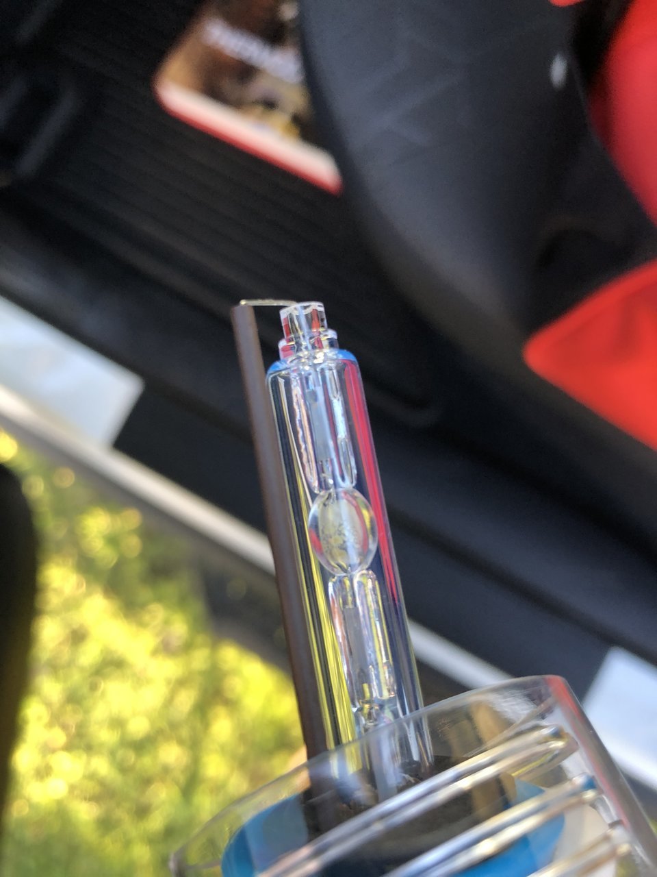

    Here are the pictures of both the bulbs and the yellow that is in the light output

    With HID bulbs, you do need to let them settle in which can take about 100 hours of usage. As for the picture you provided, the yellow you see is from the cut off since it's a close-up picture which is perfectly normal.

    So the yellow residue that is physically inside of the bulb is normal? Because I’m pretty sure that’s what is causing the yellow light

    The color band at the top is typically a function of the shield within the projector. The residue you are referring to is just the salts and gases within the air tight capsule.
    If you're not happy with the kelvin of the bulb, then we can certainly work with you on getting a higher kelvin bulb. Just keep in mind that the higher you go in terms of kelvin, the less actual useable light output the bulb emits.
