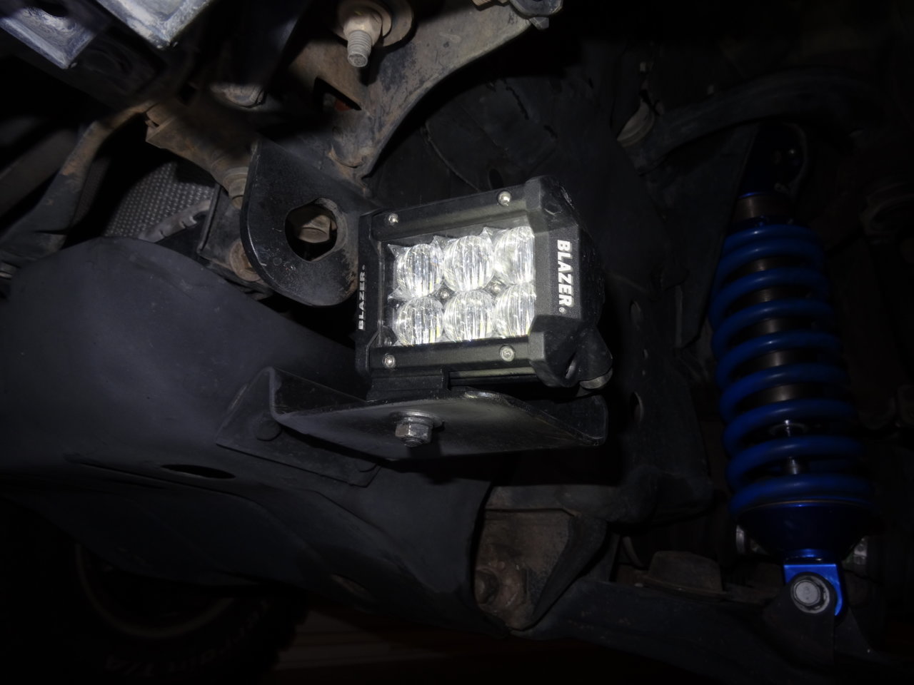

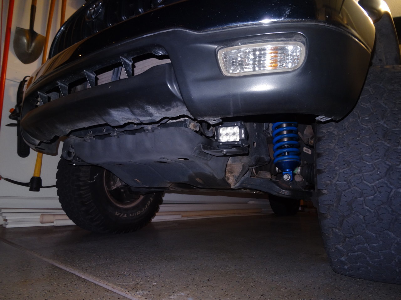

    To be honest, you can't really see them in the daytime. I set them deep in the well to let the front shroud chop off the top of the beam. I can use them on the street and not blind anyone, but they light the ground in front of the truck really well.
    The brackets were made with 1/8" mild steel and bolted to the skidplate. Painted with Rustoleum Oil base.
