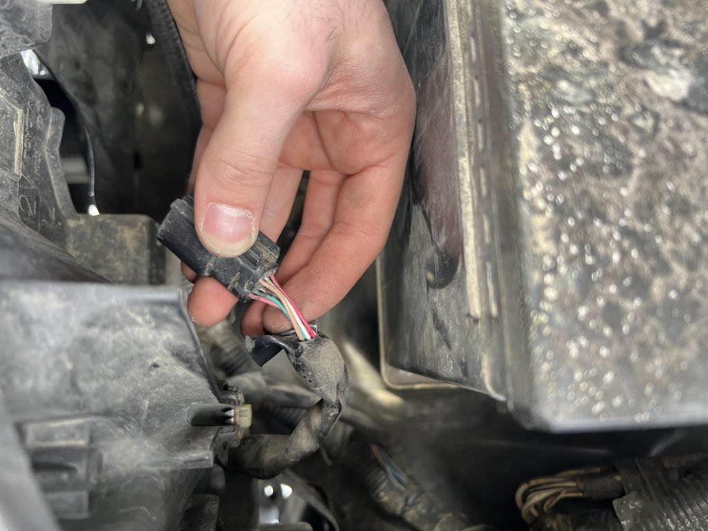

    Hey everyone. I got some rough country fog lights. They come with an extra white wire to splice into your DRL lights.
    For my headlight I only have one harness, the colors are tan, dark pink, light pink, green and white/black.
    Does anyone know which one I can splice into so when I turn my DRLs my amber fog lights come on?

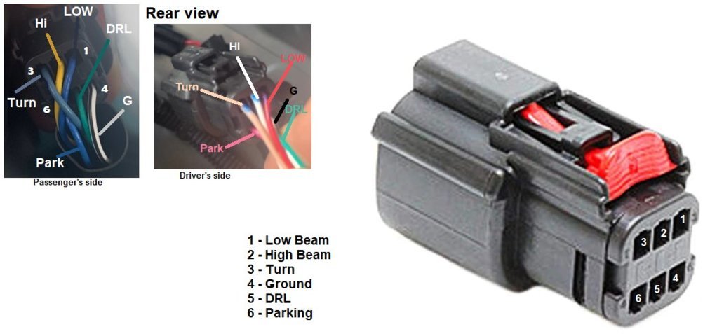

    @MrilyaB If you want to avoid splicing, I can make you a set of tees with lead for the DRL broken out. $50 for a set.
    And green is the DRL.
