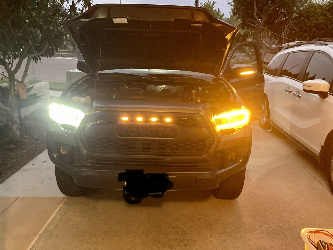

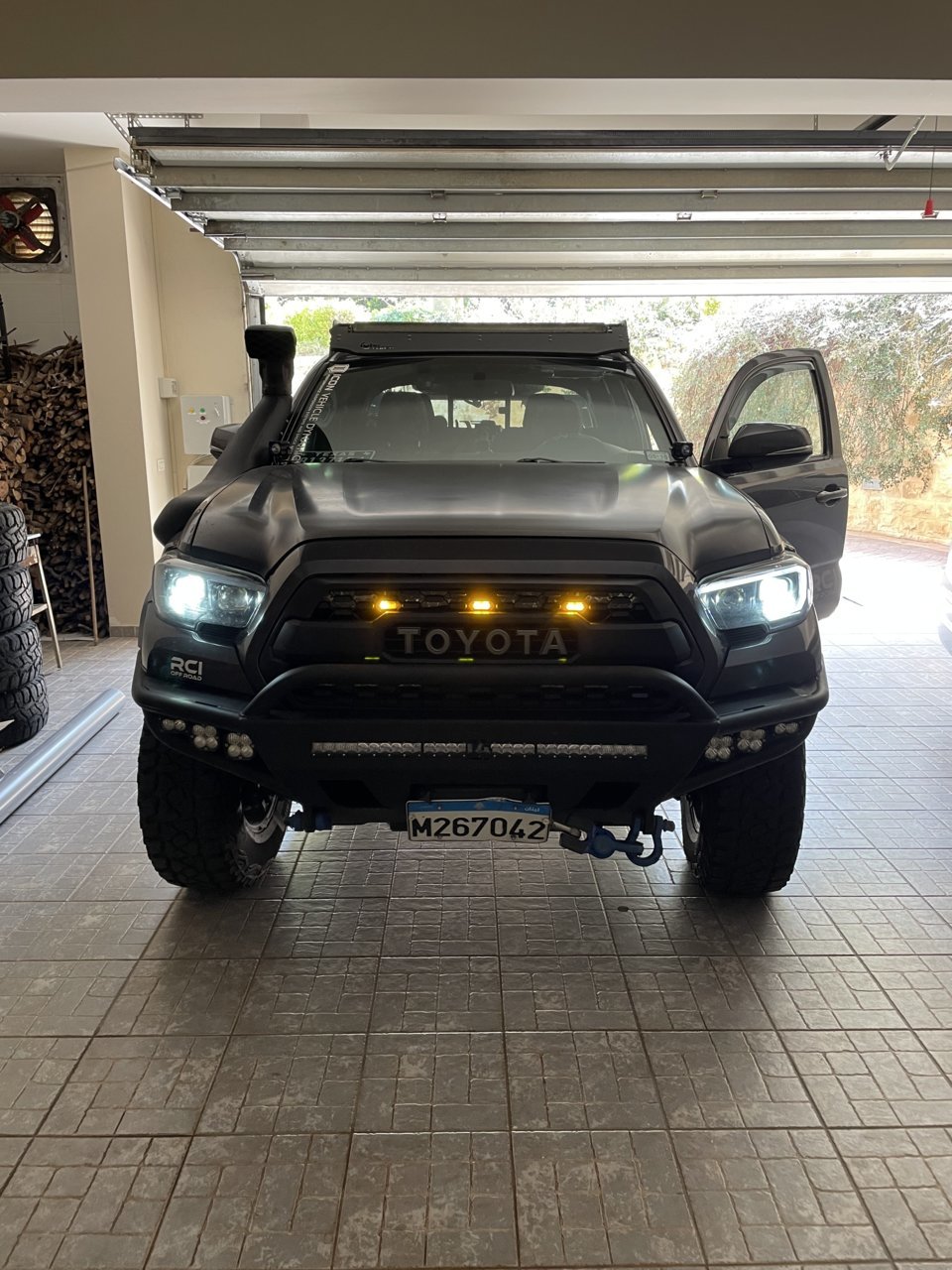

    The DRLs work fine, both on when low beams are off. One the low beams are on the passenger side DRL is off. Anyone know why this is happening? Thanks.

    Maybe an optical illusion but is there an issue with your front alignment? The passenger wheel looks way more toed out than the drivers side

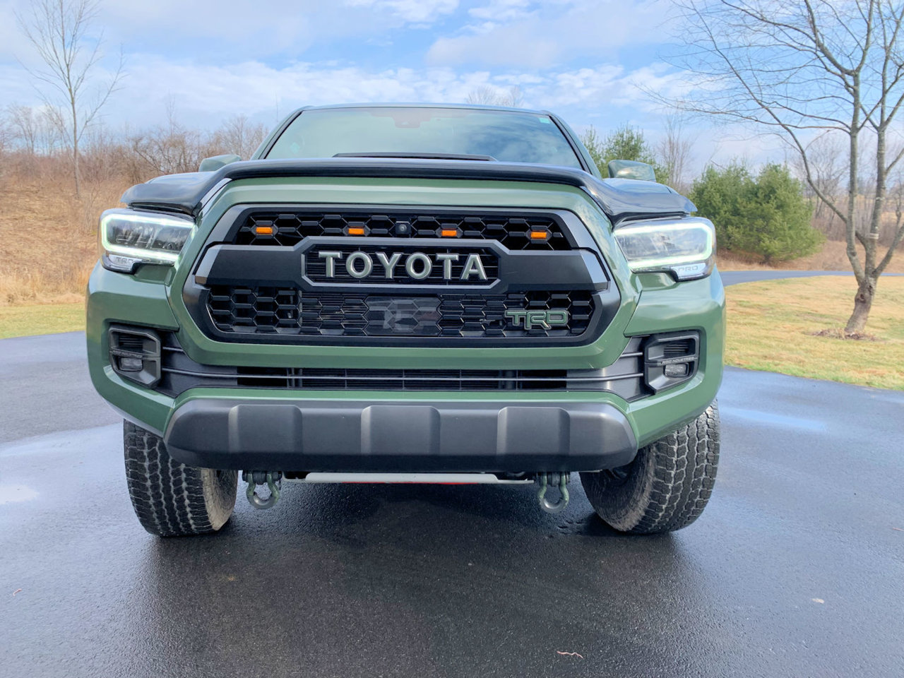

    It's probably just an illusion with the angle of the camera. I took this picture the other day - looks like my left front is significantly different than the right but my alignment is fine. Just the angle of the picture.

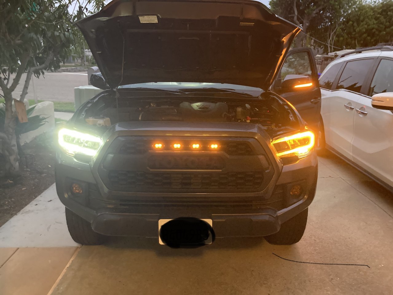

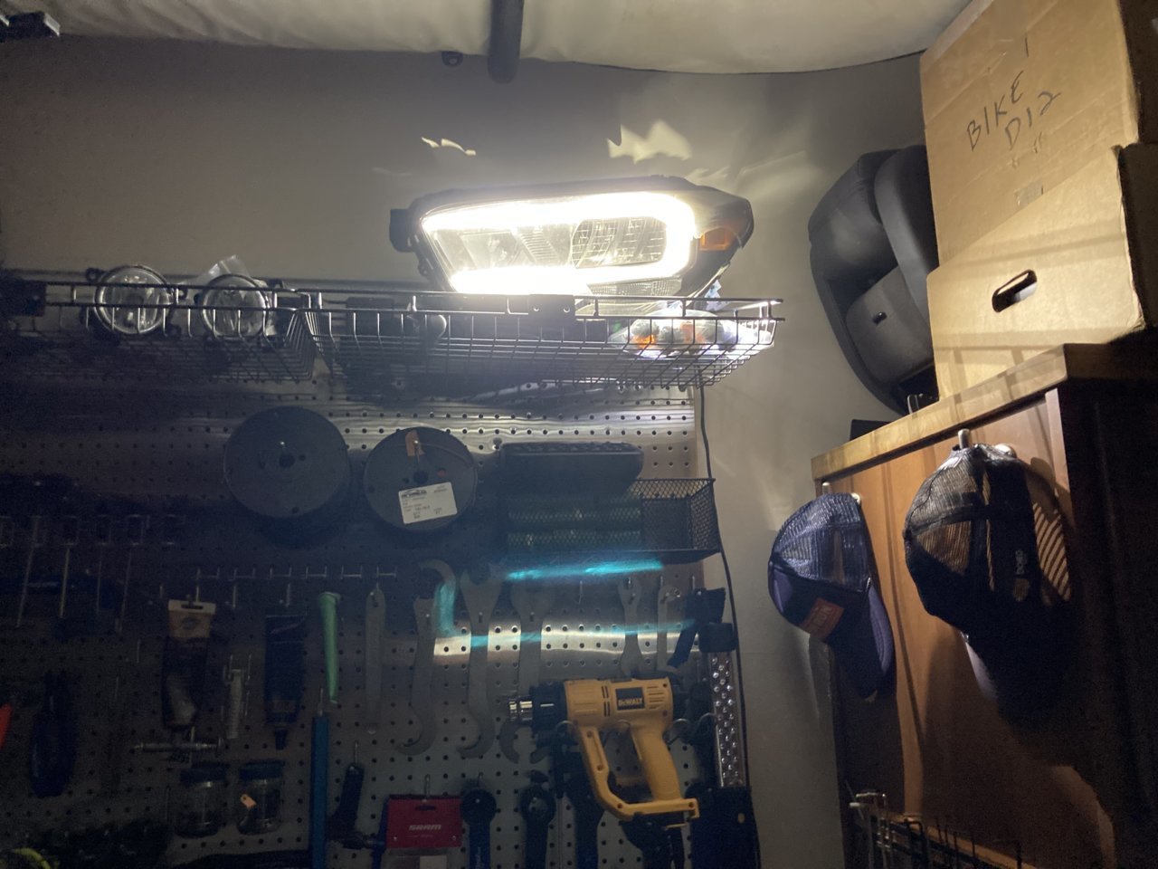

    Parking light on the OEM is dimmer than full bright DRL. The DRL signal turns off when the low beams turn on. Hard to photograph though.

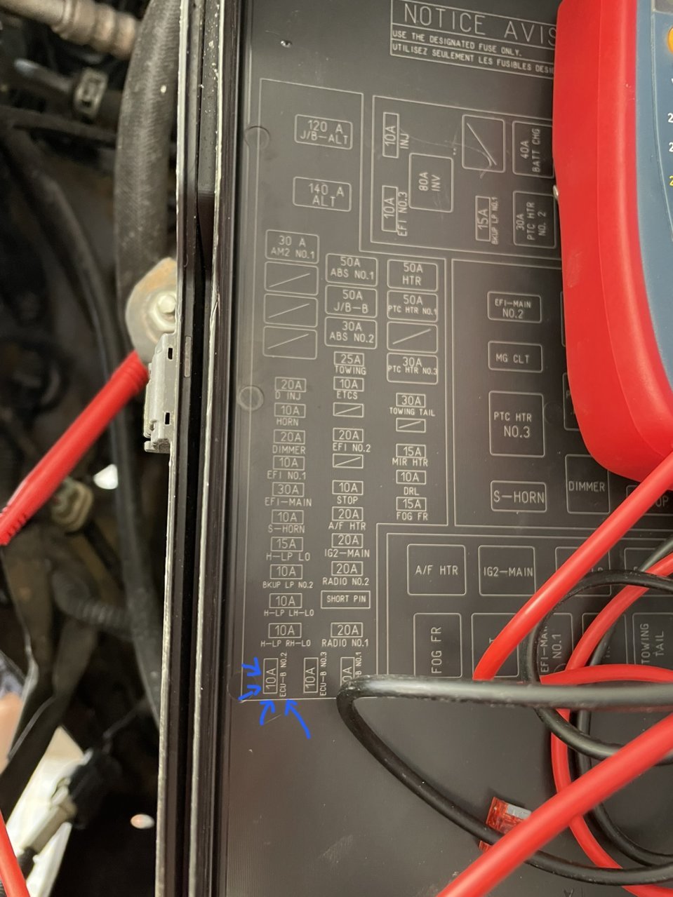

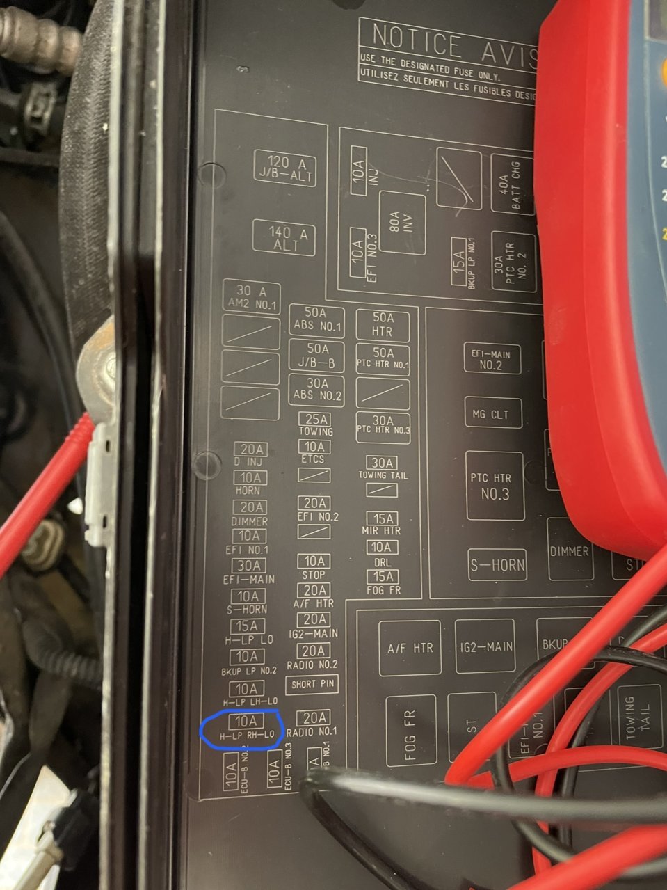

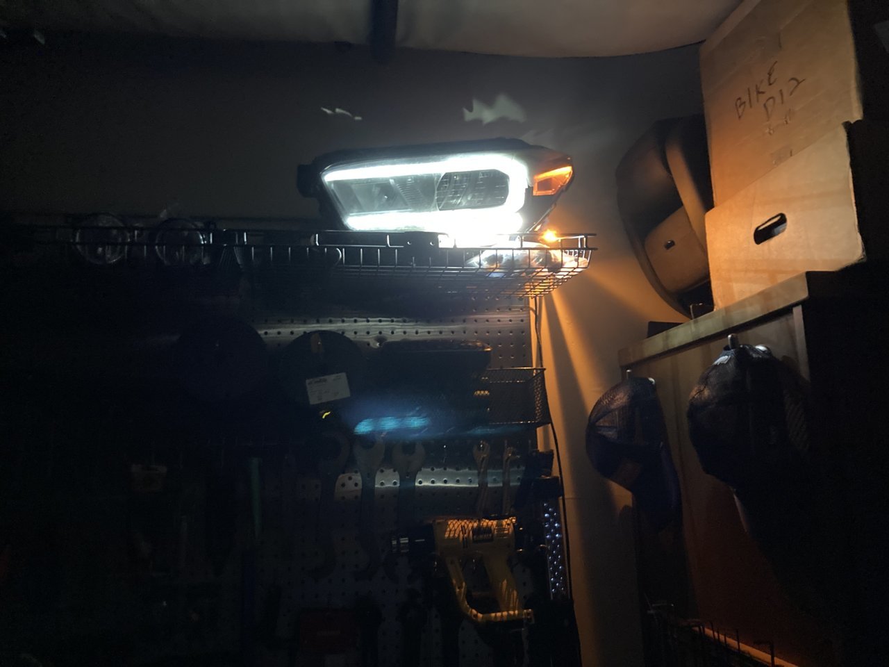

    I’m so confused. When I pull this fuse out, the DRL comes back on but the headlight turns off. Put the fuse back in the DRL turns off headlight back on.
