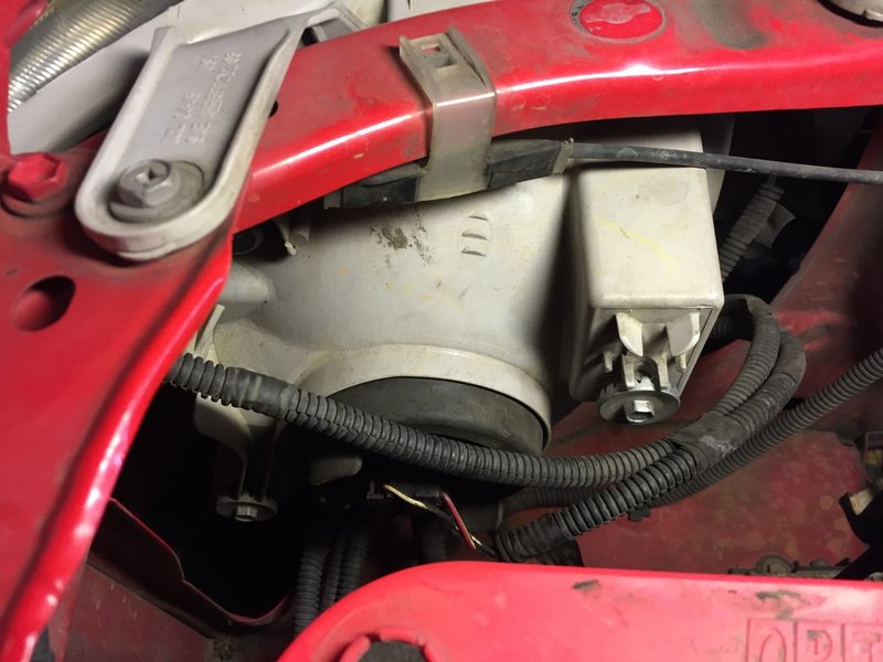

    which adjustment screw changes which direction for the headlights? I turned both but not much happened. This is the driver side pic

    The upper screw closest to the grille is horizontal, I wouldnt mess with it. The lower screw closest to the fender is vertical. I park with the lights on the garage door at night and use tape to see how far it has moved when I feel the need for an adjustment.

    Try using something like your garage or a wall to help you adjust them too, should help.

    Done and done! Hopefully I got the horizontal back to spec, probably a bit off though. Test drive is needed.
    Thanks guys.
