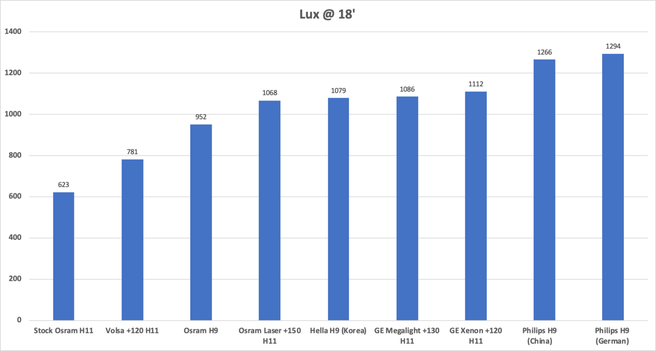

    This output chart from the linked thread may be helpful. The Philips H9s are the most effective upgrade for the halogen projector lights. Better results can be had by swapping to the OEM LED headlights as discussed in post #3 in the thread.
