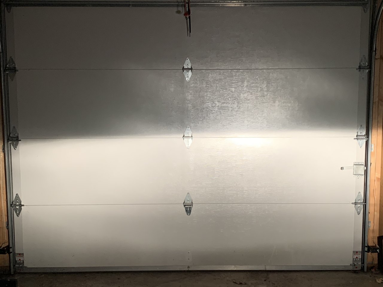

    You are right, that post is old and there have been significant improvements in LEDs since then. I've largely stopped maintaining that post because there are constant LED releases that people think will be drastically different than the one before, even though they share the same design flaws, and glare is actually not the easiest thing to photograph. While a few companies actually work toward viable LED replacements for halogen assemblies, the most difficult by far is dual filament bulbs like the 9003/H4 in a 2nd Gen. No company has been able to get this to work within SAE compliance limits that I am aware of. Philips is widely regarded as the best out there. Below is the Philips H4 LED pattern of their latest LED release. It is brighter than stock. But pattern distribution is poor, and not at all uniform. The 'cut off' does not really match stock, and is not flat and level like the stock pattern.
    Latest Philips H4 LED
    Stock Osram standard H4
    There is no question that the halogen provides a superior more consistently even beam pattern over the LED, even though the LED may have a higher peak intensity. But this is a stock halogen, what if you could double the halogen output in the exact same patten, with the same pattern saturation and even distribution, but just drastically brighter? Far brighter than the LED. That is the halogen upgrade that has been referenced multiple times.
